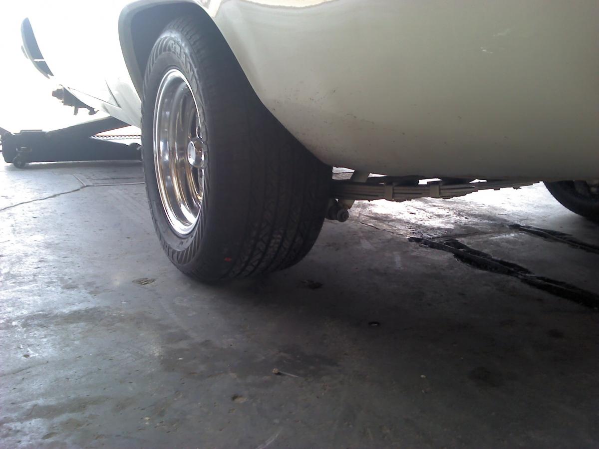

i know one.. its me. 73 RR, 15x10, 5.5" backspacking, 295/50/15 tire
oops i see you meant 5" BS.. yeah my friend has that on his 74 charger. It fits, but sticks out of the wheel well. I would go 5.5" as it tucks under the wheel lip with space to spare.
I think the '71 and '72 Roadrunner's have a different width fender than the '73+ Also I'm pretty sure they are also wider than the Chargers.
Thanks for the reply and picture. That wheel tire combo looks spot on.
