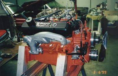

I don't have a real good picture and some mount different as well. But, here is a pic of my 70 sixpack engine showing the separator. It mounts to the front fuel pump bolt and behind the alternator bracket. The white arrow is pointed at the 5/16" return that goes back to the tank.

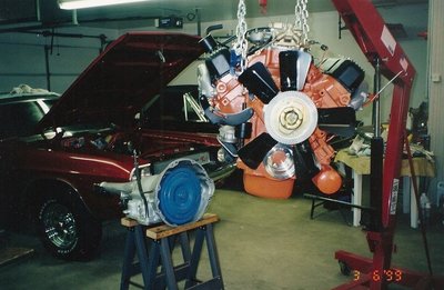

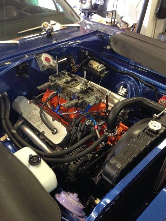

If it's not a factory correct deal I really like the promax set up. 3/8's braided. Very easy for carb tunning

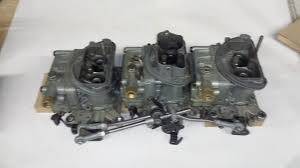

Im building a mechanical set for the rr.
A fellow board member made the linkage.
