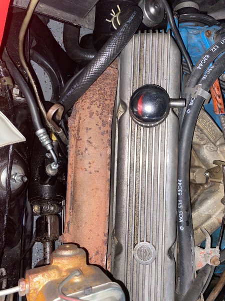

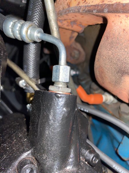

I have changed out the wires and plugs, but cannot reach #3 with any tool. It seems the oil stick tube is in the way, plus maybe the new Lares box. Ideas please!
thank y'all. I was dreading the requirement to unbolt the motor mount and raise the motor....
These guys are right. Go underneath the car and reach up with a closed end 13/16”. You can unbolt the dip stick tube & just bend it (slightly) out of the way
The correct method is proceed from underneath. From top is hard with #3. #5 and #7 gets the steering column shaft on the way but even makes a bit harder, is posible. Brake booster makes a bit uncomfortable also for the #7.
Passenger side is easier and can be made from top
