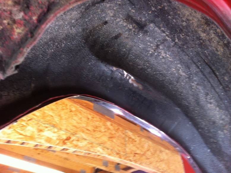

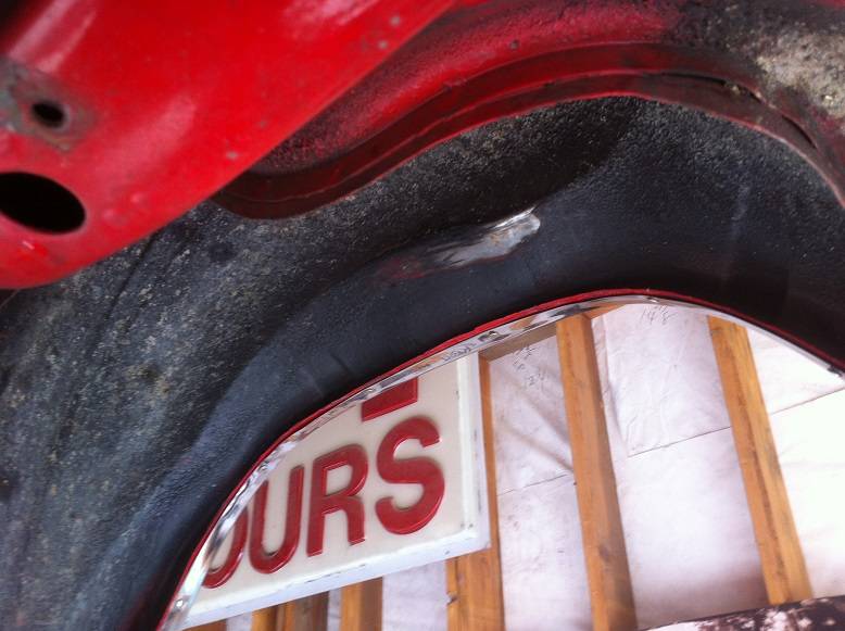

Here is a picture of those obstructions:
The problem that they present is that the quarter panel gives you the impression that you can run a tire out the the wheelwell edge. You can't do that and have adequate clearance if the car is stock height or lowered. The wheel tub does not match the contour of the quarter panel. I like a car with a wide stance and a lowered look.

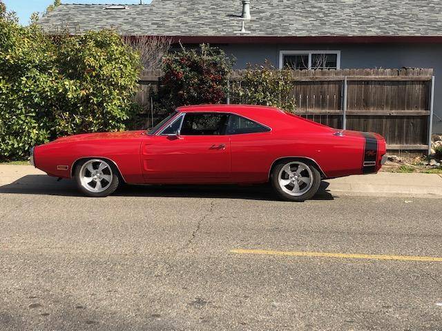

This car has a 295-45-18 in the back on 18x10 wheels with 4.75 back spacing.

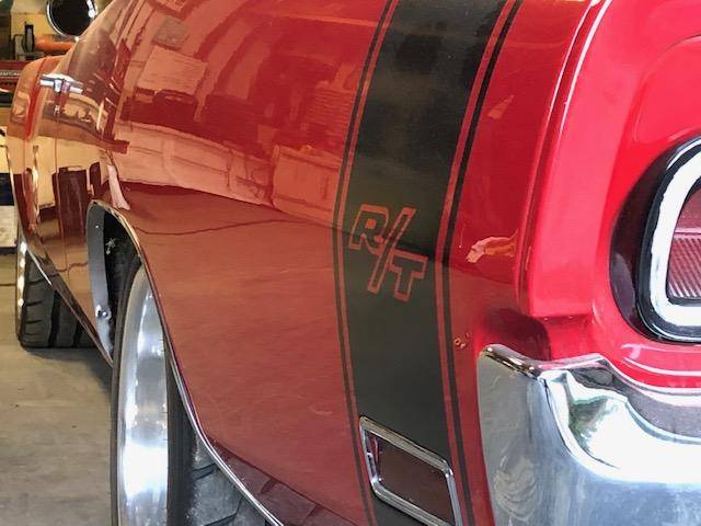

Even these tires rub that wheel tub spot. I could actually go with about 3/4" less back spacing, pushing the wheel out wider if it weren't for the wheel tub. I have another Charger that I am going to practice on modifying the wheel tub to fit a wider tire. If I can get it right by welding the patches in without damaging the ugly paint in that car, I'll feel confident to do it to this one. I've thought of cutting and patching the wheel tubs in this red car using a panel bonding adhesive but I haven't followed through on that. I prefer the idea of welding.
