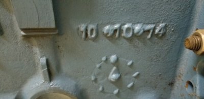

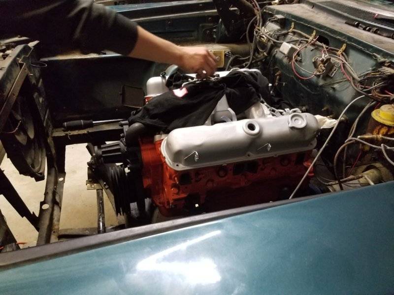

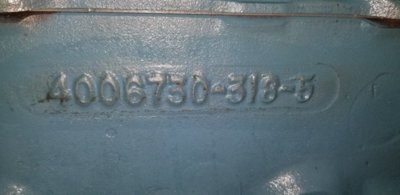

Hey everyone,
I'm rebuilding a 65 Belvedere II and replaced my slant six with a 318, engine stamp # 4006730-318-5.
I'm mating it to my 904 and have a question. How do I identify that motor? I wanted to confirm it was all going to work and I was directed to the guys at Monster Transmission. Ron there, who was awesome, also did something similar with a 65 Belveder and he stated I need to know two things - 1. is that motor the poly 318 or not and 2. is the crank balanced on it's own.
I have looked and looked and can't find anything on that motor number. Any help?
It's the LA engine and not a poly but the balance is the same.....and if it's a 67 model, it should have a forged crank. Casting date is on the side of the block.
Looks like it is a 74!
Thank you for your input! Closer to getting this thing rolling now!
Oct of 74 means it went into a 75 model vehicle. There are more numbers on the left side front just below the deck surface....should tell you more about it but cast crank teens were still internal balance.

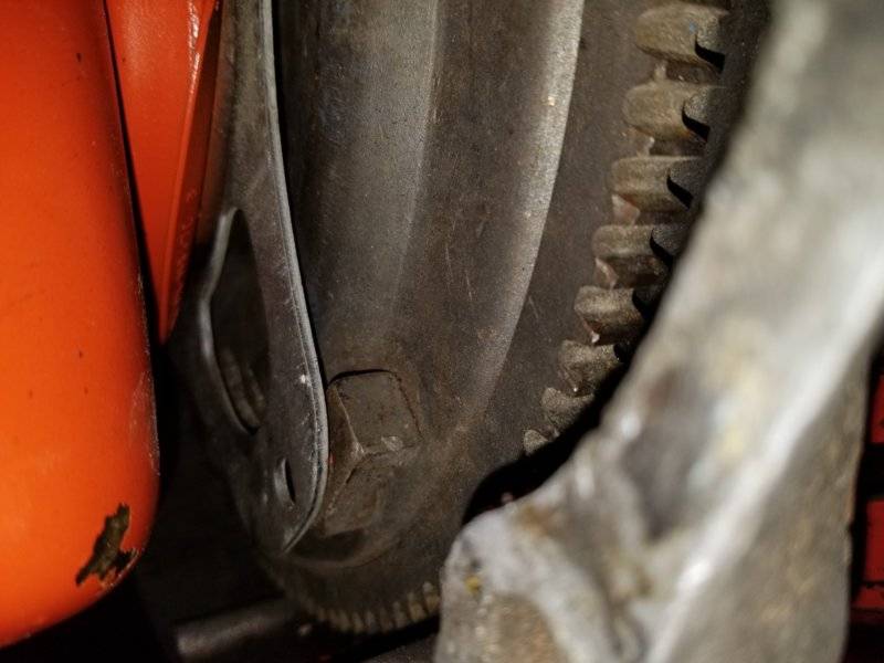

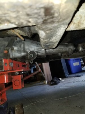

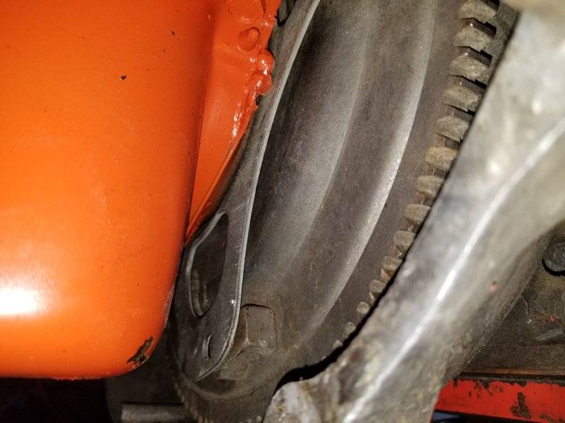

Ok, so with your help I got the correct flex plate ( I think) and attached it to the motor. I think I attached it correctly. It's concave on one side and I put that side on the motor like pics I saw online. Got the transmission mounted. And Darter6 mentioned the converter snout and possibly needing a bushing so I wanted to run these pics by you. The flex plate and torque converter holes match up, but the flex plate is about 1/8th of an inch away from the torque converter. Is this gap a problem or is it indicative of needing a bushing?

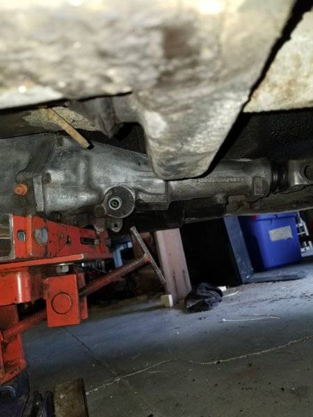

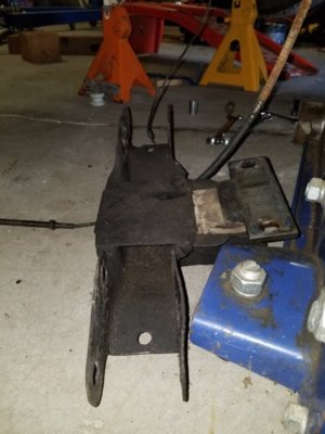

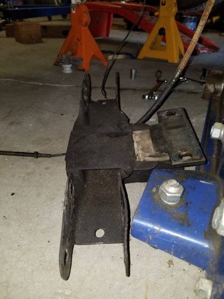

Also you mentioned the cross member. Yeah it totally isn't going to work as is. Including pics of where the transmission sites now that it is mated and pics of the cross member. Thoughts on how to modify this to make it work.
Can't say about the bushing without measurements of the converter pilot and the crank now that you have it together. The converter will move in and out and should pull up to the flex plate without any force.If you give me until this weekend I can take photos of my cross member to give you a idea.I will do my best to do that.

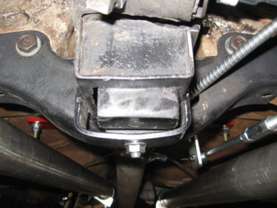

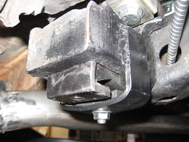

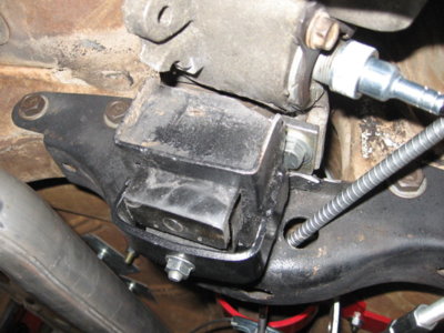

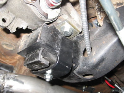

Did the best I could laying on my back for the photos. As you can see I cut the bottom out of the original cross member.Dropped in the A body tranny mount with measurements matching where the original mount was to keep correct output angle.Had to slot the mount to tranny bolt holes some.Trimmed some of the cross member to clear so no metal to metal was touching.Made a U shaped cup for the single bolt mount and welded it in place. I cut one of the mounting ears from the 904 that is used in the factory floor shift bracket thinking it was in the way but it would have cleared ok. Hope this helps you with your project.
It was a little bit rough and crude, trial and error so the finish isn't perfect, but so is the car. I call it my "Crusty Classic". We will leave "Rat Rod" to the Ford and Chevy guys.
