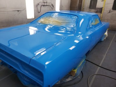

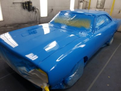

Thanks all. Great info. Was doing some pricing, and right now it seems like the small block option is best. I will keep the 383 I have as I got it for cheap. It can sit on a stand. Regarding the 360's, what about the newer magnums 5.9's? Will they fit any different than the old 360's? I think a set of gears, like 3.55's would make a big difference. I have the smaller carrier on my 8 1/4, and would need to replace the unit in order to go steeper gears. 8 3/4 units around here are almost impossible to find, and are incredibly expensive. I'm only talking 325-350 horse anyway, and dont abuse my vehicles. Anyway, a couple more pics below. Thanks again.
