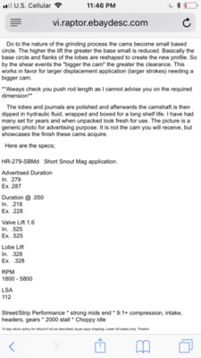

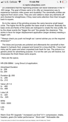

I found a few regrind roller cams for about $160. Any thoughts on these specs? I plan on running the stock short block to include pistons.

First cam with Hwy gears, stock tires, exhaust manifolds, dual exhaust @2-1/4 w/H pipe.
Second cam with 3.23’s @ a min. 3.55’s would be better. Headers a plus. 2-1/2 w/H pipe.
I’d rather these cams on a 110.

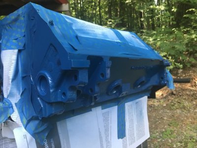

Got the block painted up today. VHT Enamel.
