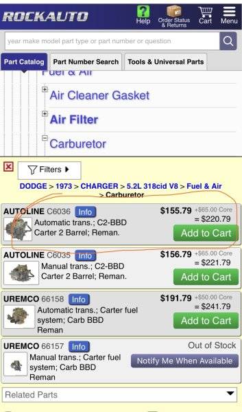

Good day. I will be in need of a new carburetor for my 73’ 318 soonish as I attempt to rebuild and realized it’s done for. So the question I have is should I keep the original(In photo) or ask what you guys suggest as an upgrade. I’d prefer a direct bolt on without changing linkage and keep it simple. I am running the stock manifold, stock head, and short block w/ upgraded cam and high compression pistons.

Just be aware that the 318 cubic inch engines used a 1-1/4" Carter BBD Carb. And the 361 & 383 inch engines used a 1-1/2" Carter BBD Carb. The difference is the mounting flange bolt spacing and the throttle plate size. The 1-1/4" BBD carb has 1-7/16" throttle bores and the 1-1/2" BBD carb has 1-9/16" throttle bores.......the two sizes DO NOT INTERCHANGE......be sure what you are buying....
