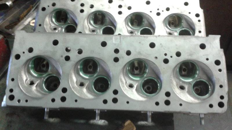

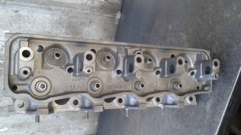

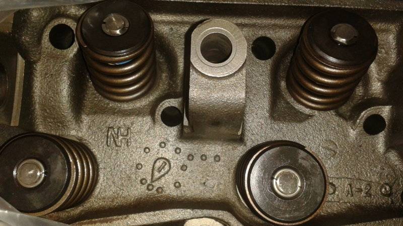

Here are my 62 Poly heads after machining. I believe it is nicknamed "the semi-hemi"
