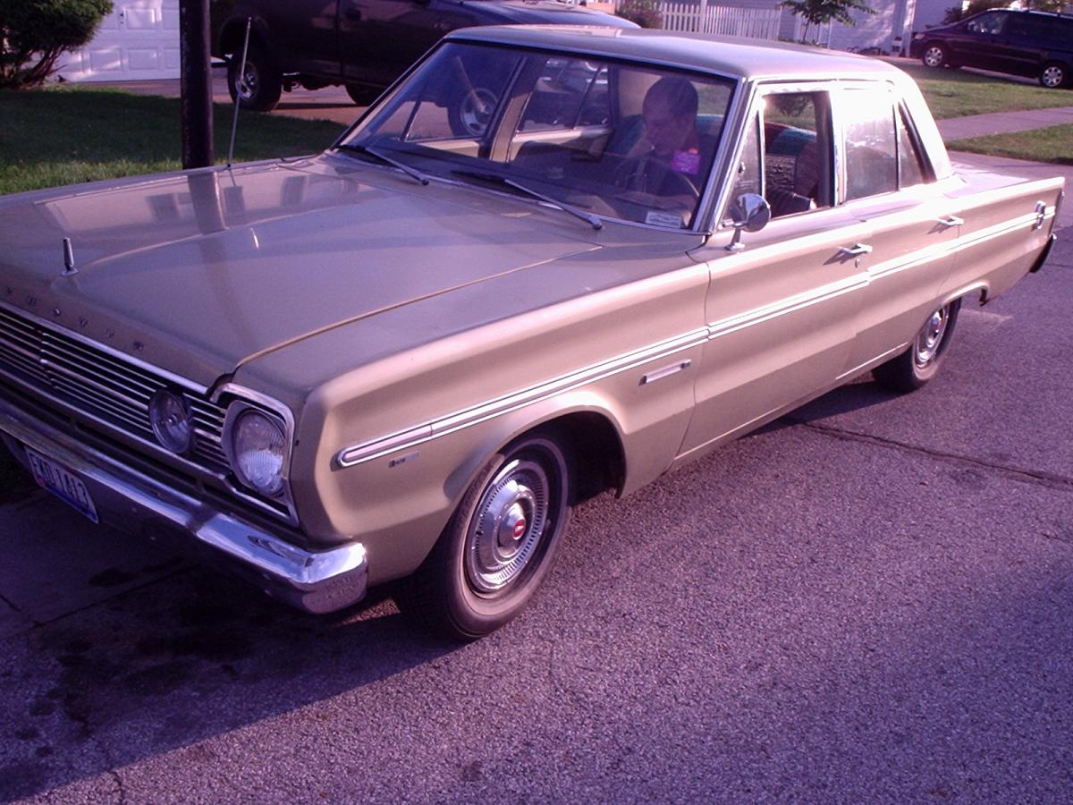

My brothers daily driver has oil in the anti freeze.It is not bad,he is still driving it to work.10 miles rouind trip.I have a set of rebuilt poly heads.I think it just needs head gaskets.My question is the lifters hydraulic or solids.The car just turned 80k mi.I think we should change the oil pump,timing gear,waterpump (original on it now).My brother had an extra set of valve cover powder coated hemi black.I am looking forward to seeing what those look like on the motor.

There isn't any "it isn't bad" when there is oil in the water. It IS bad, and he should probably stop driving it like last week. Continuing to drive it can do more damage.
Maaaaybe you can get away with changing the heads and not blowing out the rings. Maybe not.

He has to drive it.Maybe if the weather is decent this weekend we could change it out.I have my 68 Dart in the garage ,I guess I could let it set out this weekend and work on his car in the garage.I have never messed with the polys,just smallblocks and a few b-blocks.Are the rocker armc on the polys adjustable?
would have to be with solid lifters. i,m gonna pull a valve cover on the one i have stored
I'd be looking into the oil in the coolant issue before I start thinking about a timing chain - though it probably needs that too as it's probably a nylon top sprocket and all the nylon teeth are in the oil pickup.
Valve lash settings could be .010" on the intake and .020" on the exhaust. That will be close enough to make it run. These are factory slant six settings.
I doubt the rockers will work on the LA because they are probably a different ratio. They resemble the HEMI layout.
I've delt with many Polys in my 70 years. I think you have a blown head gasket!
