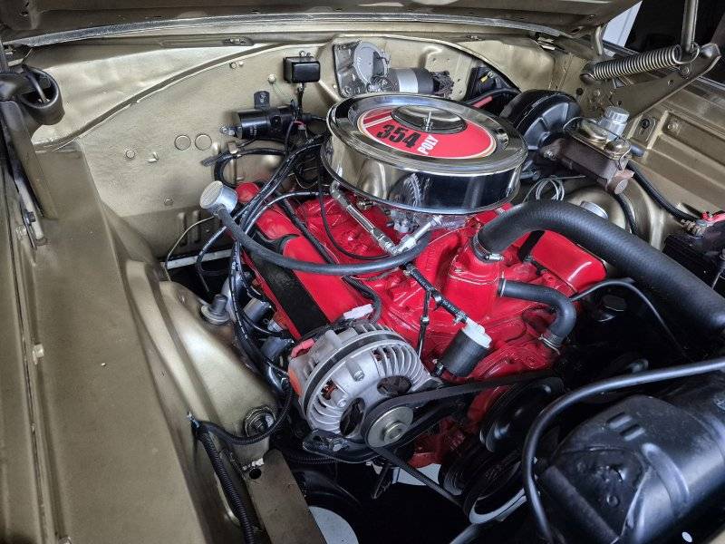

Poly in my 64 wagon, someone else spent the $ on a rebuild, runs great, TTI headers, 2 barrel.
It can get out of it's own way no problem.
This thing is great on gas too.

Mine...just added A/C

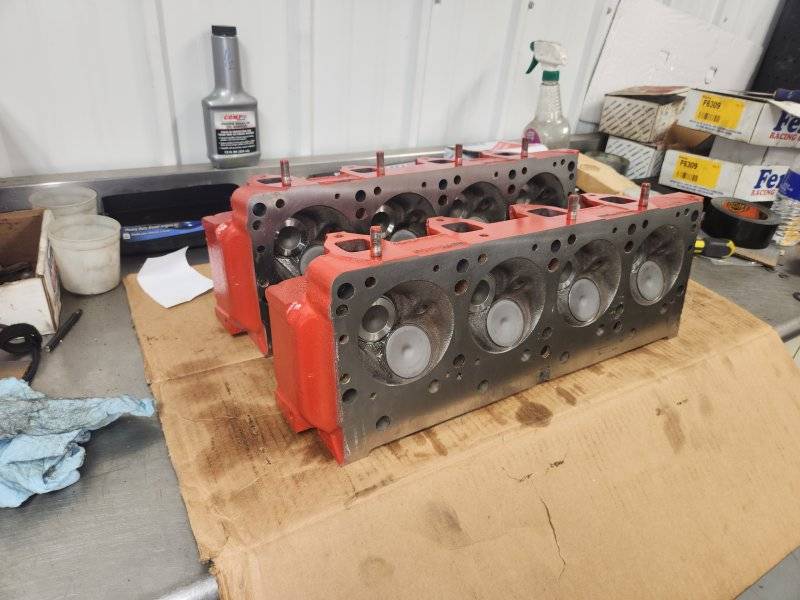

Just had the poly 318 rebuilt for my 64 fury. Original engine with 98000 miles. I have about 300 miles on it before the snow came. Very satisfied with the rebuild.
