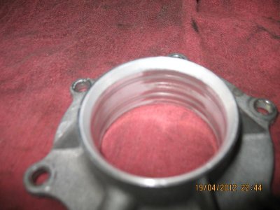

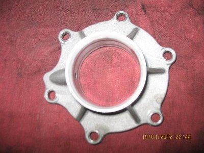

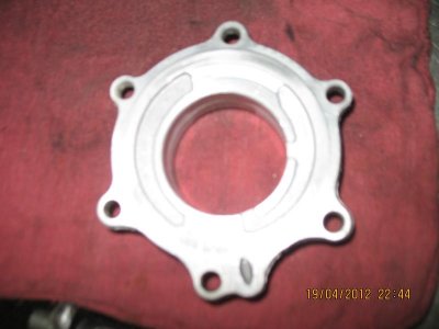

got the "new" 727 b/b cable shift delivered to the transmission shop. everything was looking good in the quick go through till....
the rear pump cover has terminal scorning where the seals for the govoner ride. i am too deep in this with shipping and the $500 for the trans(great deal if...) so anyone have a REAR PUMP COVER from a 64-65 CABLE SHIFT 727 . pm me please. i am dead in the water with the engine swap till i get one. any suggestions where to get one retail is welcome too. posting this up on the mopar forums and craigs list. guese will start calling the bone yards on saturday.

photo's of what i need. and why . if i can't locate one guese i will bolt it all up and set it aside till engine is done and ready to swap . then pull the cover off the one in the car. though hope to sell that one with the perfictly good 318 i am pulling. might try sleaving it to as a worst case ...

$100 latter
guy in wisco is going to go through his 4 727 cable shifts trannys and get me a good pump cover. $100 + shipping ..... up side is will have it by end of next week and can keep moving forward.
found it on ebay shipped to the door for 35$ . back in the game.
