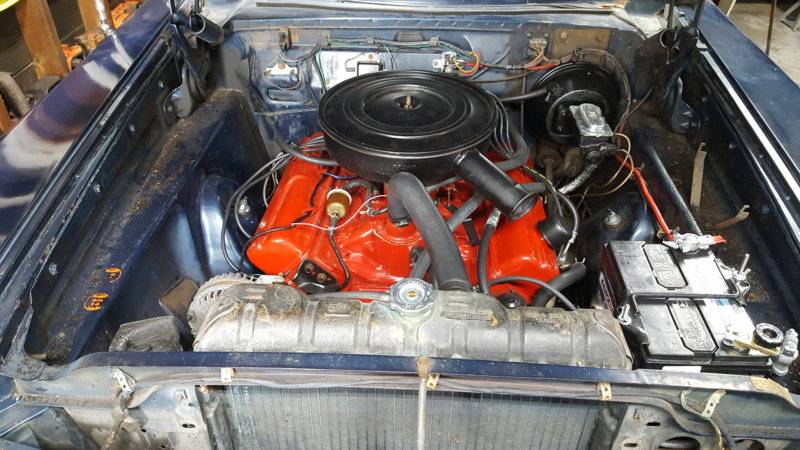

Issue: slight vibration, never there for months, now remains constant at any rpm, never gets worse.
Details on everything:
Replaced an existing 318 poly in a 64 Fury that needed a rebuild with a running 318 poly from a 65 Plymouth that was rebuilt a number of years ago. I swapped my valve cover, oil pan and pickup. Motor is extremely clean inside, I painted the outside.
New MSD distributor, coil, starter and relay, voltage regulator, belts hoses, engine mounts, headers/exhaust, etc.
Battery came from another running car I had, alternator was tested and good.

This is where the vibration started. Starts right up, idles nice, but has a slight vibration, which is the same at any rpm.
Vibration can be felt best on tops of fenders in front, on top of air cleaner, and sometimes with steering wheel at idle.

Ran extremely well, really well, nothing new there, but that vibration. Vibration is more obvious, if that is the correct term, seems more prevalent at the right front, passenger side.
I was holding a small long screwdriver leaning on the passenger fender and noticed the upper horn vibrating, then I noticed the screwdriver in my hand vibrating at the same frequency.

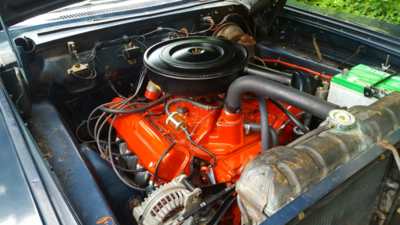

Looking at pics to check what I did and when, never saw wiring before with numbers on the wires
