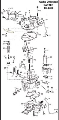

See #35, this could be your idle problem, these need to removed from carb and cleaned, there tiny holes is these that must open for proper idle.
in some cases these are corroded, if that is the case the carb must be replaced.

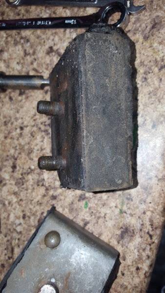

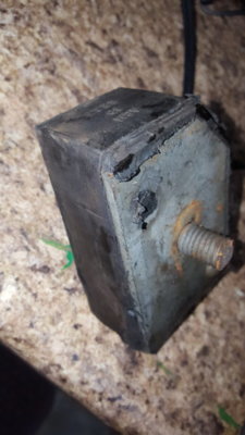

I like using the kiss principle, which led me to swap 1 motor mount, even though both are brand new, I checked them multiple times, removed one once too.
The old one is brick hard, when I pulled the new one it didn't fall apart, it's not ripped or destroyed, I put it in a vice and it doesn't compress, it doesn't twist, nothing.
See if you see a difference in the before and after glass of water test.

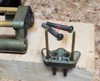

Carb: I pulled the #35 tubes out, air goes through no problem, WD40 too. Same with the hollow bolts that hold it down. Then I noticed what appeared to be tiny threads clumped on one screw at the top 'port' just below the head. And I mean tiny, stuck there, air didn't blow them off.
New cheap toothbrush and some more cleaning/air, done.
Put it back together, idled fine. Took it for a ride, no stalling. Ran on when turned off, lowered idle screw, fixed.
Smells a tad rich, so I'll check the timing and idle mix screws in a few days.
