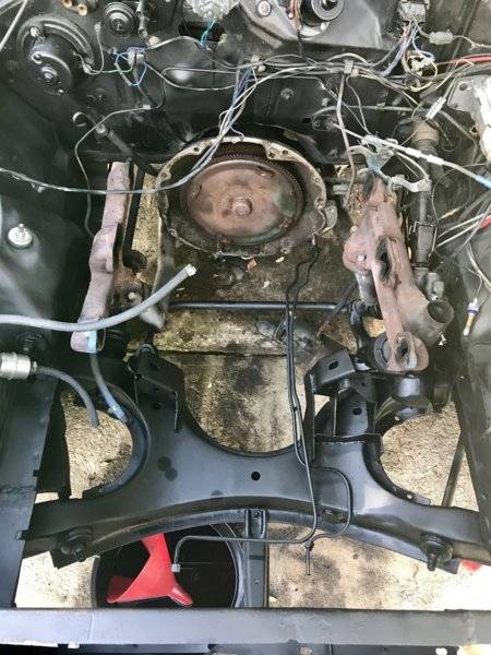

This is a pic of my engine compartment when I swapped my 318 for a 360. Now I am itching for a 383 or 440 for my ‘70 Belvedere. Will the BB bolt to this K member? I know I will need a new trans and drive shaft mods. I already replaced the leaf springs with 440 springs and replaced shocks with BB rated shocks. It’s an AC car and has the 26” radiator. So does it bolt in and are there any other large pitfalls I am missing?
Note: this is a car show/Power Tour cruiser. Not a race car, so I’m hoping I can avoid the torque box and anybody rear end change issues. I think it’s a 7 3/4 rear end.
The k frame will work fine, all you need are the metal mounts that bolt to the engine. They are around 150 bucks from Mancini Racing. You will most likely find the limits of that rear end fairly quickly, so plan on an 8 3/4 upgrade soon.

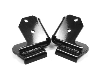

I have a 62 Fury that has a 383 and this is what we have. Like burntorn70 said they sell them at Mancini. Mine are 55 years old but are identical.
These brackets are required IN ADDITION TO the mounting brackets and insulators used for B/RB installation in '63-65 B-Body.
Actually those are for your 62 only K-frame. 63-72 don't need those.

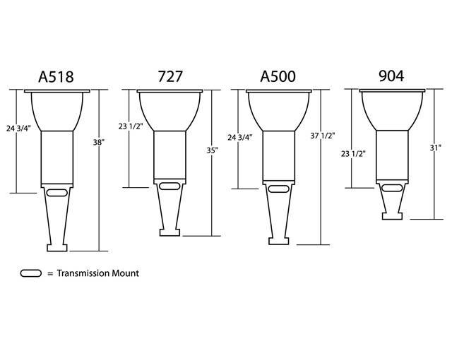

I do have the 904. Will I need a different trans support brace for the 727 too?
Sonny you can use your 904 transmission crossmember as it is the same for a 727 transmission, the transmission mount is 23 1/2 inches from the front for both transmissions. You just need a 727 driveshaft and yoke or shorten the 904 and the different yoke for a 727 and have it balanced, the 727 has a longer tailshaft then the 904.

thanks for the chart moes
better than my scribbled notes
I'm going to add the diameters at teh back to aid in tunnel mods
