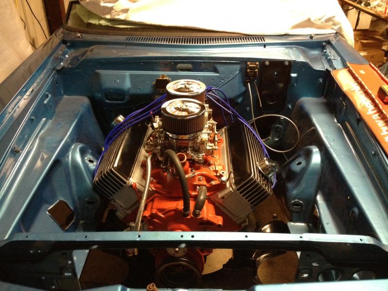

Build the poly, When I open my hood everyone asks, "is that a 440"? Nice conversation piece. Here's mine

NICE!
Al heads????

I painted the heads with aluminum engine paint. alot of people have asked if they are aluminum. I don't believe anyone makes AL heads for the poly. The steel heads can be ported well and built to support the 402 stroker for a good chunk of change.
