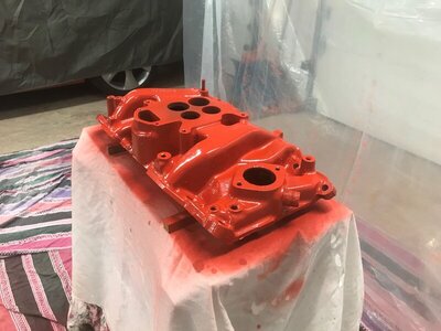

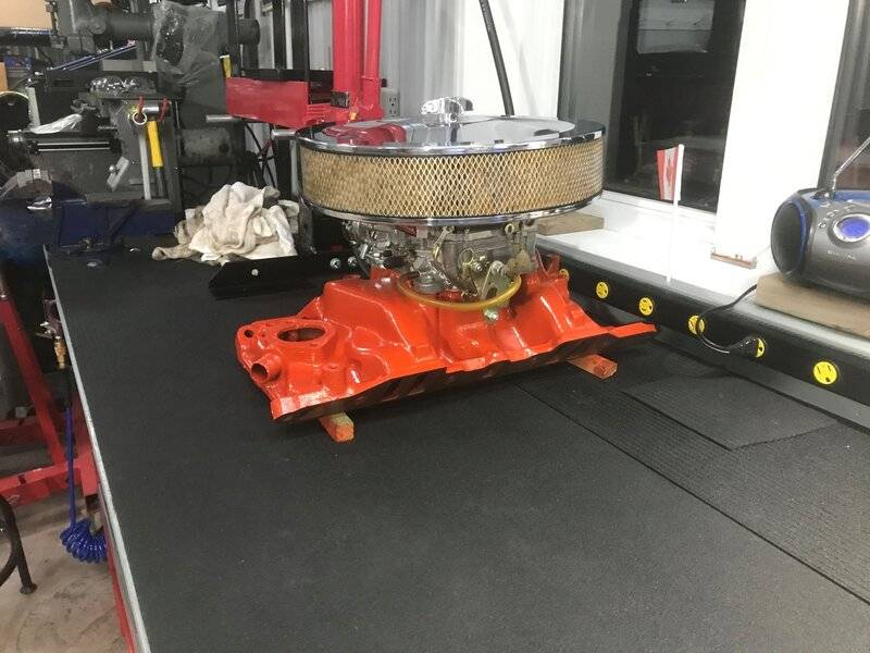

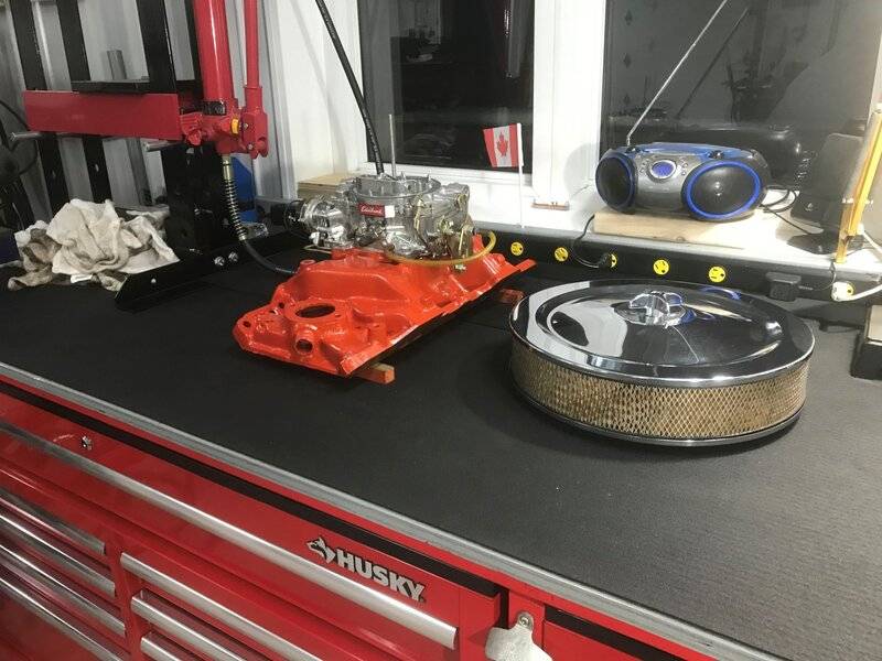

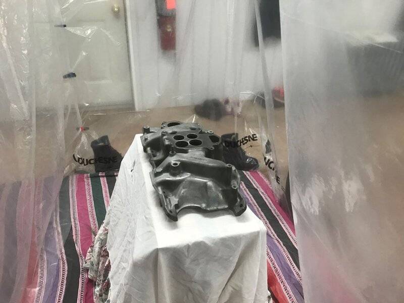

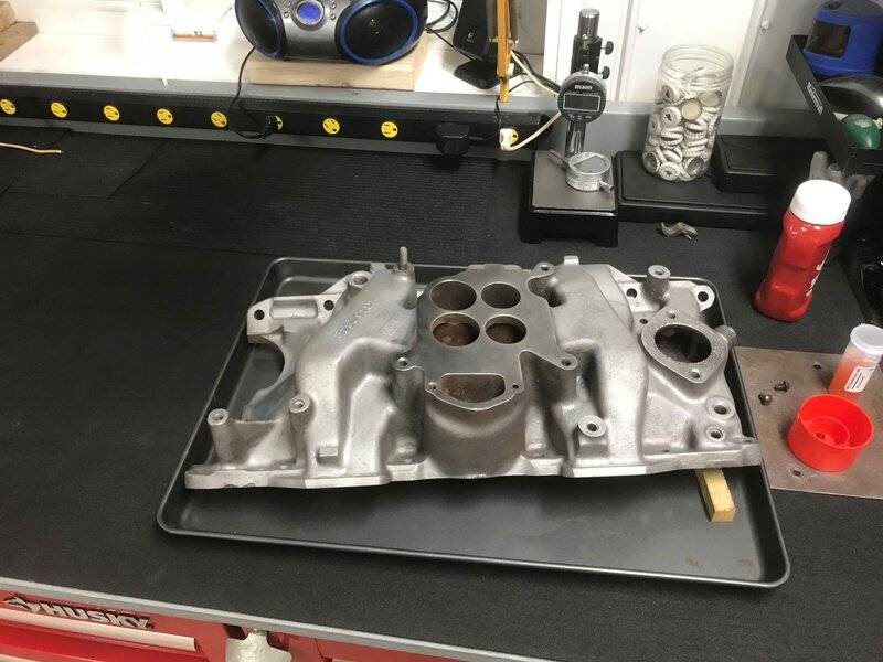

Well guys like I said earlier, since I have nothing to put this on to at this time. My plans were to just clean it up/blast and paint it up for a wall hanger more or less. Well wont be on the wall but will find someplace to put it. Spent last night blasting away at it. Cleaned pretty nicely. Finished it off this morning giving it a coat of Mopar Performance Hemi orange. Set it on my radiator to bake the paint all day and then this evening I chucked my Eddy on along with a old breather just to give it a finished look. Like I said now I have to figure out where to "display" it.
Here are a few pictures of the process. My big paint booth! lol

You said it Kim. No aluminum here. Just nice and heavy cast. What a bear to wrestle around the blast cabinet last night!
