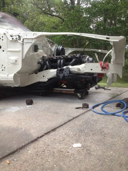

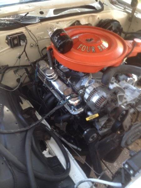

For illustration purposes only.
This just happens to be a ‘79 Magnum.
