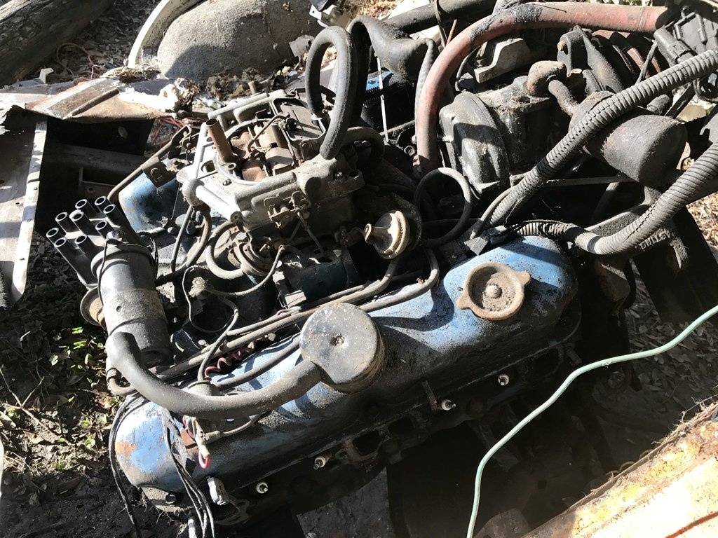

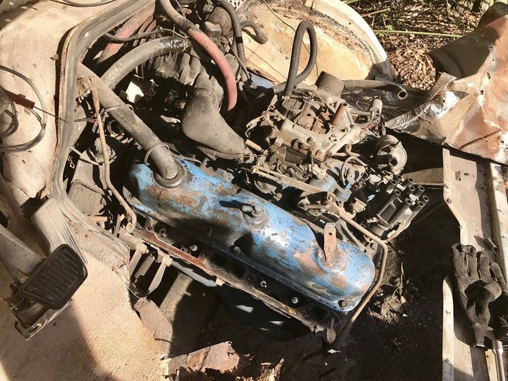

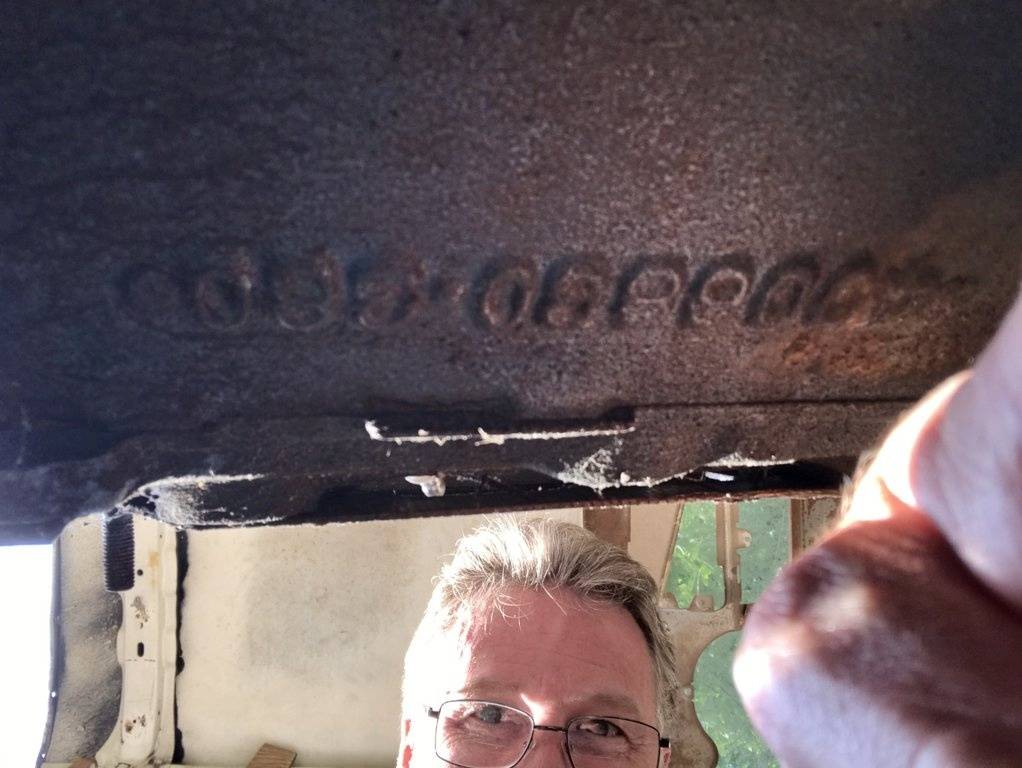

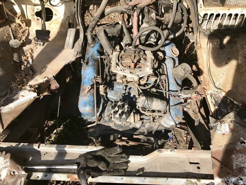

Here is the 360 I'm going to swap my 318 for. I'm using my 904 trans (not building a race car). The numbers are: 4006830 360 and pass side 28678. So the story goes, it's a crate engine with less than 40,000 miles. I'm paying $180 for it. Rotating assembly turns freely and compression stroke is tight. Freeze plugs look new, and under the valve covers are sludge free. There is a roof over it so no water intrusion. Any thoughts before I pull the trigger today? Thanks!
You don't get much more complete than that! A battery and gas can and you could verify it runs right where it sits in the photos.

Anyone know what that large hose in the driver valve cover is for???
Looks like a breather size geometry that could have has a hose
To the air cleaner. I don't know for sure.

I'd grab it .the drivers side hose is to the air cleaner the second one looks like a common modification that we do in the scca racing so when you turn hard oil doesn't spew out it travels up the hose then back down
View attachment 491163 View attachment 491164 View attachment 491165 View attachment 491166 Here is the 360 I'm going to swap my 318 for. I'm using my 904 trans (not building a race car). The numbers are: 4006830 360 and pass side 28678. So the story goes, it's a crate engine with less than 40,000 miles. I'm paying $180 for it. Rotating assembly turns freely and compression stroke is tight. Freeze plugs look new, and under the valve covers are sludge free. There is a roof over it so no water intrusion. Any thoughts before I pull the trigger today? Thanks!
The tube on the driver side valve cover is the oil fill tube. this is a van motor. and from the photo you can see the van shroud seals as well as the van/truck oil pan.
x2
