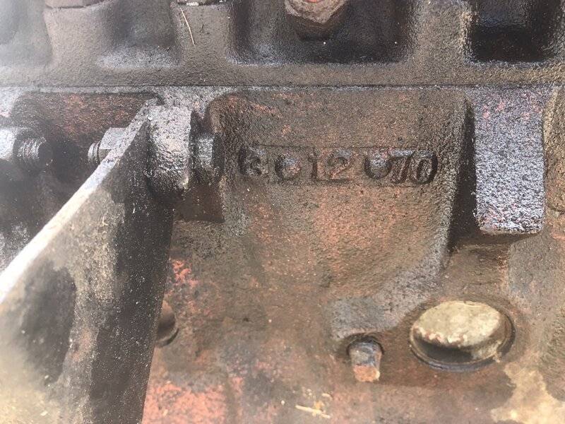

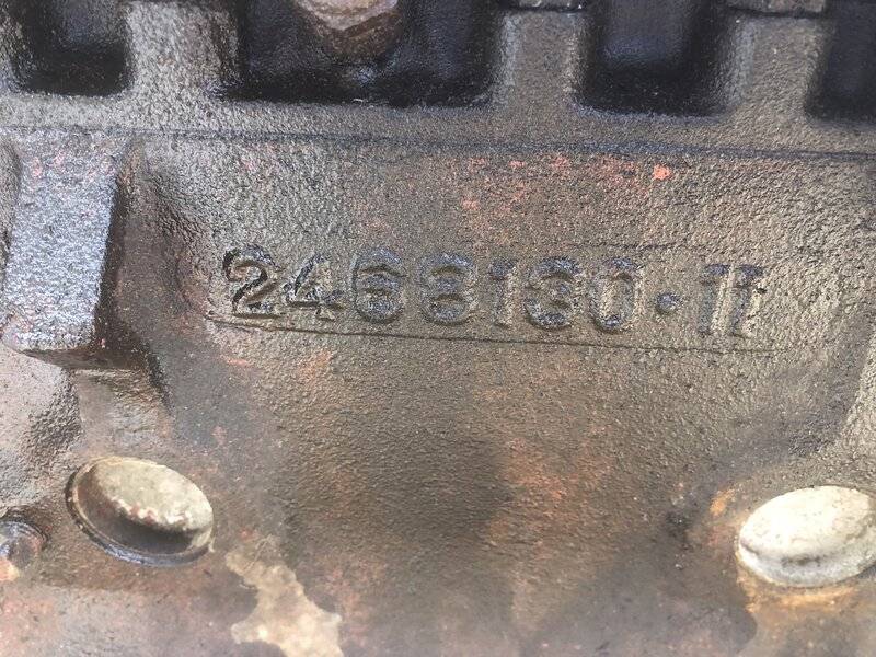

OK, so I picked up what was supposed to be a 440 RB complete motor with 727 out of a mid-70's motor home chassis. However, once I was able to run the numbers from the purchase, I didn't have a 440, I had a 383, specifically:
Casting No. 2468130-11, date stamped Mar 1970. So, that's not bad, a 1970 383, should be 9.5:1 compression, factory specs says 330hp, so I can use this somewhere, someday.

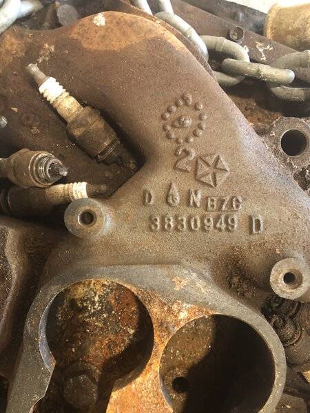

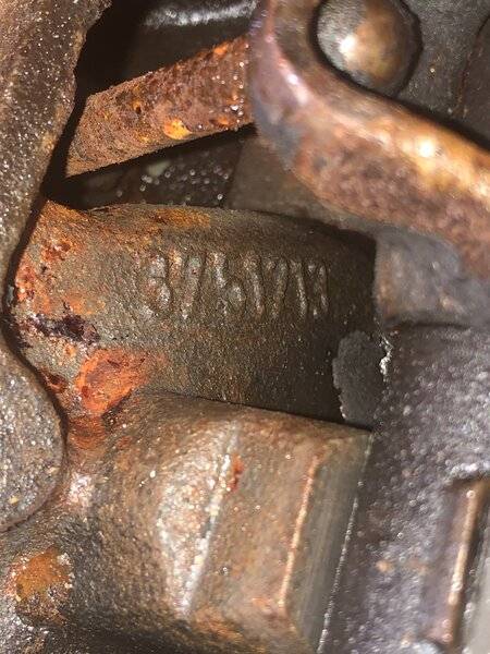

Now, this is where it gets weird, I went and looked up the intake and heads, cause the seller was sure it was a 440. Well, the intake and heads are as follows:
Intake Casting No. 3830949 - 400 4bbl intake, 75-76 production date
Heads Casting No. 3751213 - (2.08/1.74) 1973 400/440 motor home heads

should say 440 or 383 in casting no. on side of block, also 440 has flat id pad on top next to dist hole , 383 has id pad straight under dist on block by head gasket surface.
The B and RB engines use the same heads so you are ok. The intake if cast as you say is for a 440 only and won’t fit on a 383. 383 and 400 can only be used on a 361, 383 or 400 block because both are low deck blocks where as the 440 intake can be used on RB blocks such as the 413, 426 wedge and 440.

Is this intake actually bolted on? I would like to see pictures. The only way it could and that.s if it can be done the intake and heads would have to have about 5/8 milled off.
I don’t have one to look at, but doing a search shows many listings of that number being sold as a 400 piece.
https://www.forcbodiesonly.com/mopa...ead-bore-intake-3830949-75-southern-md.50151/
I think we’ll agree that the OP’s block casting number is clearly a 383....... and the manifold appears to be bolted down.
If that’s the case...... it’s obviously not a 440 manifold.

Sorry but I can't comment on the heads but it looks like the intake is for a spreadbore so it would likely have had a ThermoQuad (which is pretty cool).

Looks like you have an older 383 block with newer year style heads and intake. Take a picture of the ID pad which should be under the distributor hole as that can tell us more than the block casting.
That block would have had 906 heads and somebody switched them out to what you have now. Pretty much all big block heads will fit B block ( 361-383-400 ) or RB block ( 413-426-440 ) so no mystery there.
The intakes is where a difference is, B block intakes will not fit RB blocks as they aren't wide enough and RB intakes are too wide to fit B blocks.
The crank should be a forged internally balanced one. Picture of the dampener would determine internal or external balanced.
