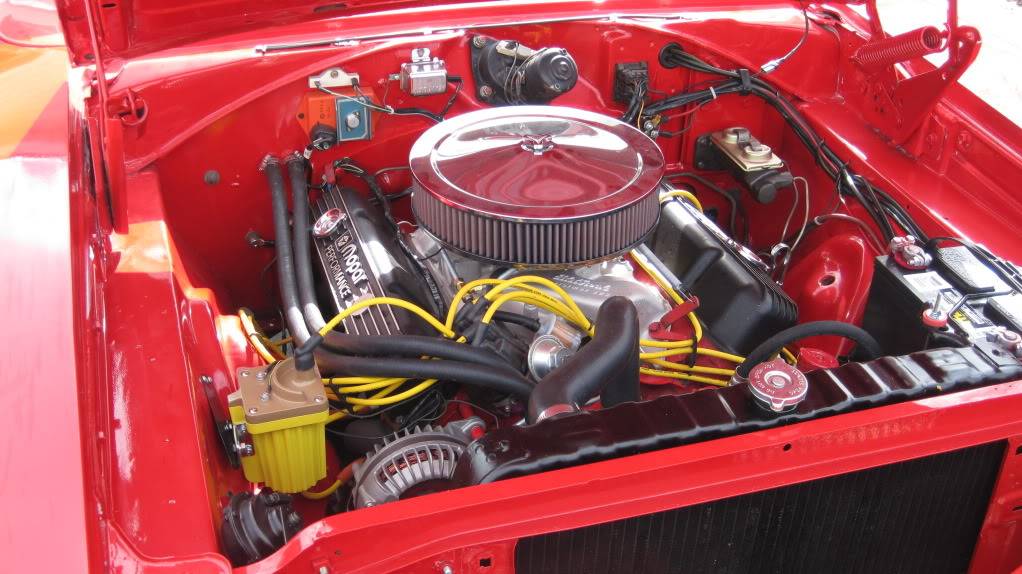

If you have electronic ignition you will see something that looks like the orange controller on the firewall as in this pic. (yours could be a different color though). If you have points you will not have one.
I have an electronic ignition. Once the timing is verified, I'm assuming that I set the idle mixture first (using the idle mixture screw(s) and a vacuum gauge, followed by the idle speed. If I'm correct, what (idle speed) rpm should I be looking at once the car has warmed up..if not what step did I miss.

Thanks 68ChargerAG. I have an appt with my Buddy next weekend to do this stuff, but I'll have to get my vacuum gauge first. I'll keep the 600 rpm (auto for me) in mind. B.T.W. I like the shot of your engine area, very clean and well done. I'm impressed and learning to appreciate all the work involved more and more with these classics.
