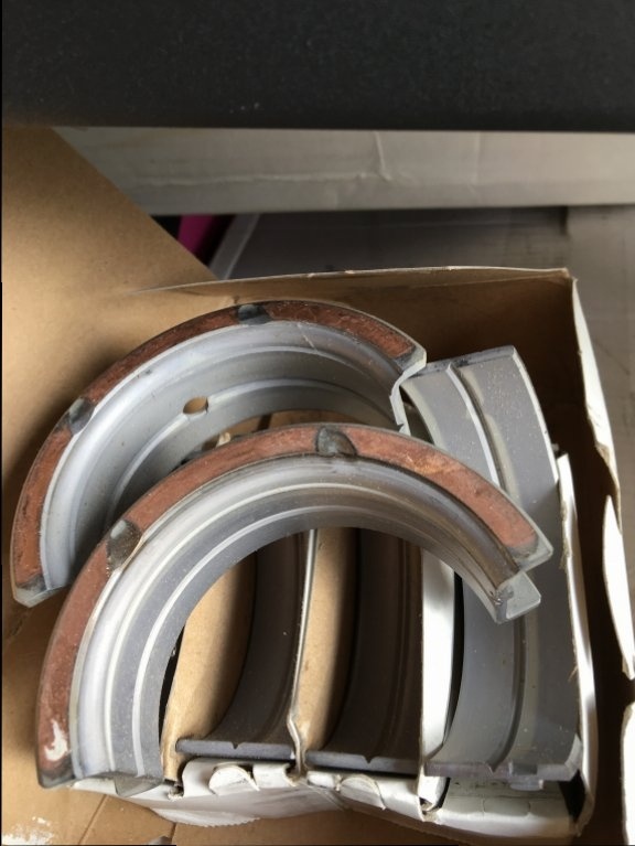

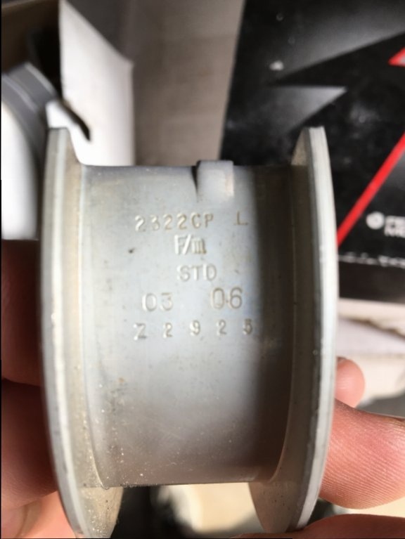

Well mine are full groove standards but they are 2006 so you are welcome to them may make a difference
Not sure how tight you want it but maybe try .001 bearings they do sell them.
anybody know if the OEM 1/2 groove 383 main bearings are available anymore? the only thing i can find is the full groove truck bearing.
I checked and all I have is a std set of full grove mains, new in the box
