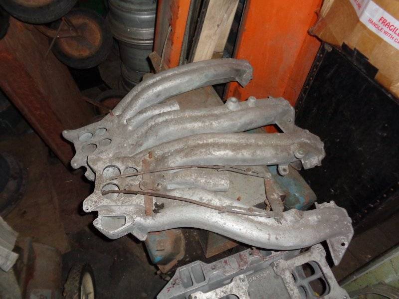

it was a two year motor offering in the chrysler golden lion line . i've got one . the crank shaft has non threaded holes like the early motors , and it has 4 bolt valve covers like all the early wedges . it's just a small bore block , much like the 413 block , and 426 wedge block . going to use my long induction rams on mine .

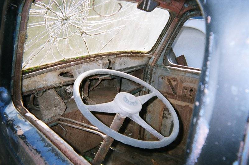

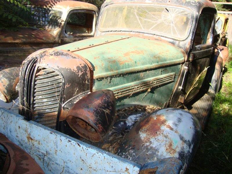

that engine an auto push button type in this 37 dodge pu , it had a 54 cad v8 and trans in it when i bought it . as you can see it got cut on some , so to make her into a custom rod will not hurt it at all , lol .

the motor is complete 4bbl carb kept under shop out of the weather .
