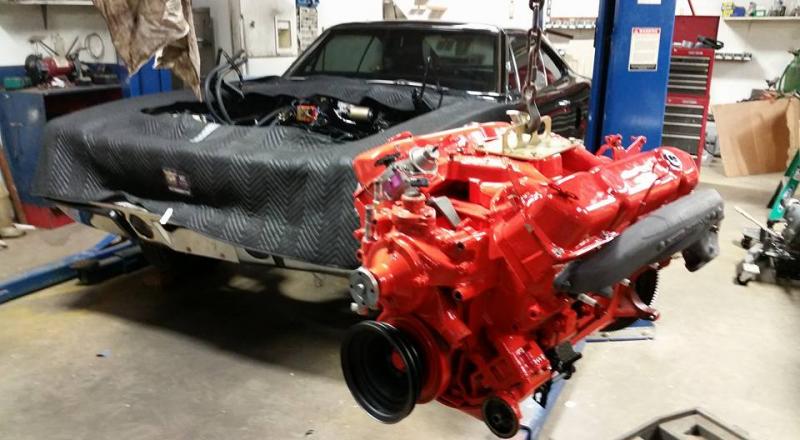

Hello all.Well leaving the tired engine in place didn't last long.After finding a experienced Mopar engine builder through a friend of a friend that believes in getting things done I pulled engine over the weekend and dropped it off this AM.We agreed that he will install a good 438 stroker kit,906 heads with the big valves,roller cam and roller lifters ,new rockers and a 750 Holley with mech secondarys.While trans is out gonna refresh it and the shifter too.If that won't wake her up nothing will. motor on stand.jpg
That should work!
If that's your 383 in the photo why is it red?
Its orange,just looks that way in photo
So it is the Police/High performance 383...nice.
