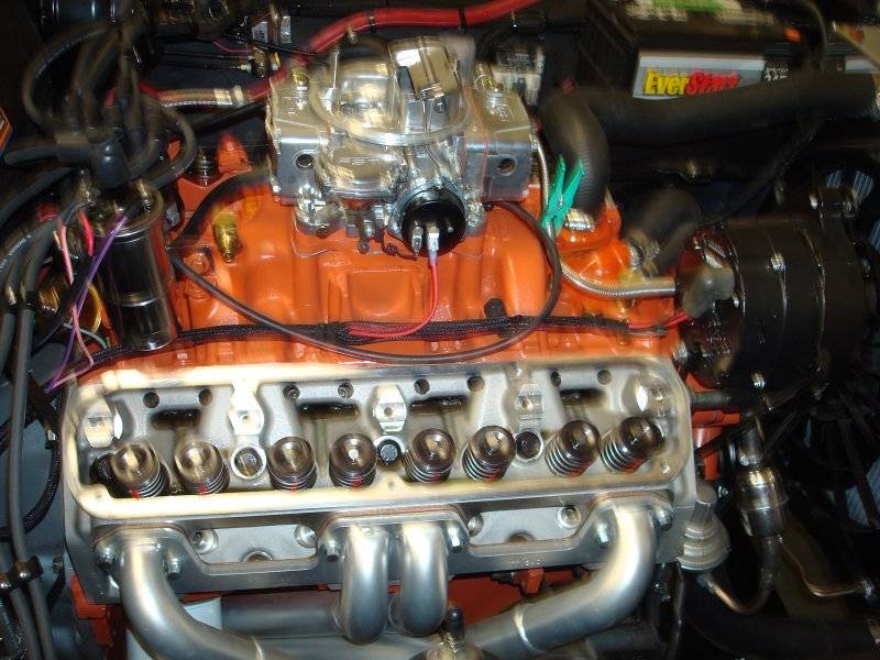

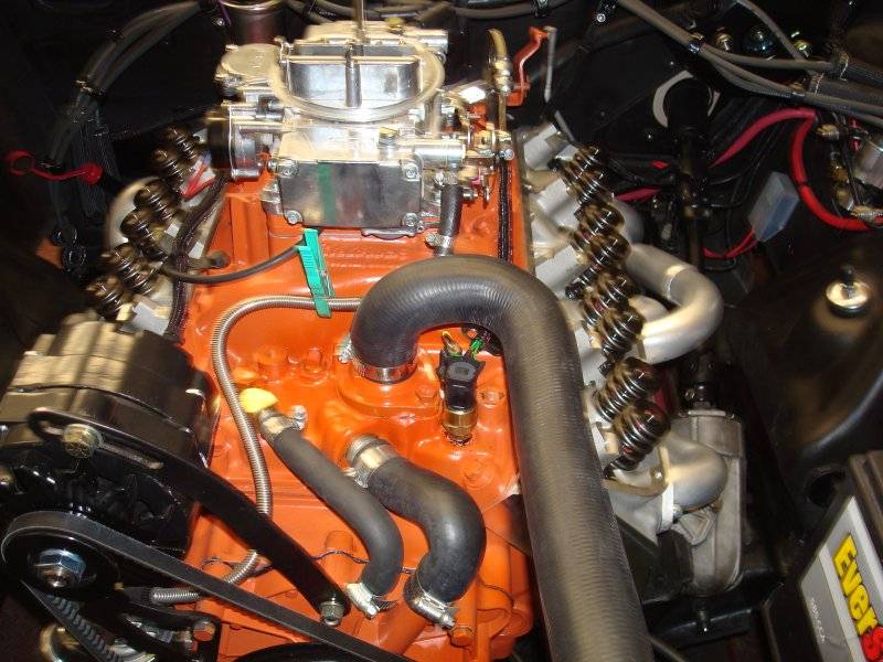

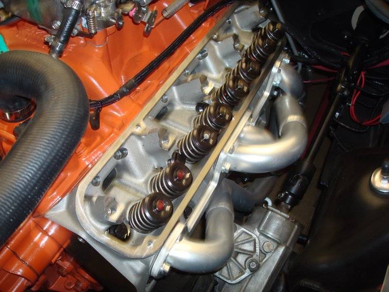

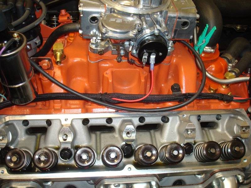

Can you throw up a pic of what this stuff looks like. We're making assumptions with no pictures = bad.
Topend with the valvecover off

yes #1 was on base intake and exhaust wife is trying to figure out sending pics these are speedmaster alumn. heads comp cam 20-222-3 .470 exhaust lift with the stock rocker arms witch I'm using and they are off the engine right now
Here are the pictures. Please let me know if you have any suggestions.
Maybe its the camera flipping the image. Do you have the correct rockers on the correct side? Im not sure you can even put them together backwards but its worth asking.
these were the rockers that was on the engine before rebuild they are as they came off engine just a bad picture they all look good no wear in cup or valve stem flats of rockers.
