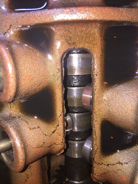

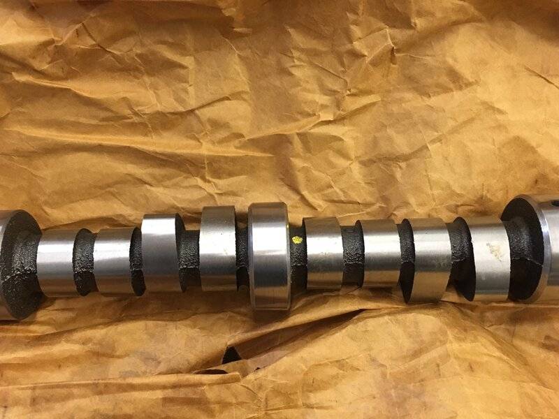

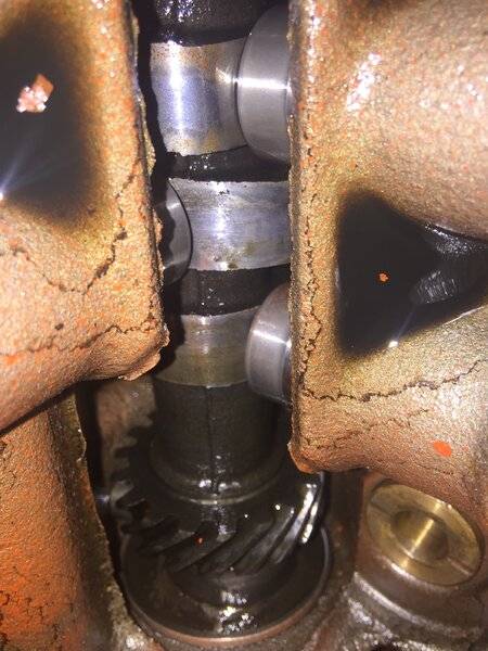

The bottom picture is where the lifter wasn’t spinning. As far as I know, it’s a stock purple cam.
DC425213-FF04-4CC4-BFC1-4E16104F0C6B.jpeg 087E5F42-BF15-4983-ABBD-22AF57A8624D.jpeg 768CF049-4D34-41F6-921B-0286D68111AE.jpeg image.jpg

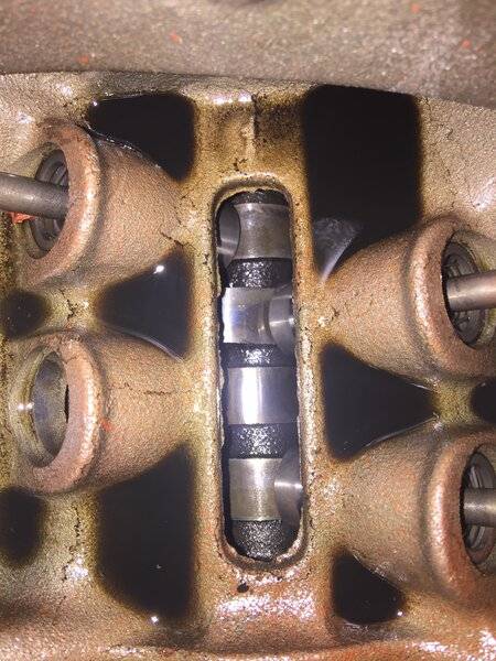

If you put #1 on TDC during overlap....... then take a pic showing how even the tops of the lifters are, it should help narrow it down.
Several of those lobes look like they don’t have adequate taper.
Or the lifters don’t have adequate crown.
Btw...... do you know what the cam is?

Unless something has changed...... it’s not a Mopar cam.
Mopar hasn’t parkerized cams in many years.
(I haven’t bought one in ages, so that may have changed)

With “most” cams, there will not be a lot of difference in how much the lifters are up off the base circle at TDC.
So, if there is a big discrepancy in the lifter height at TDC...... the cam is likely phased(installed) incorrectly.

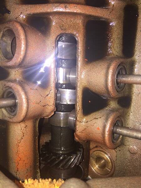

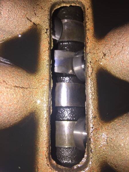

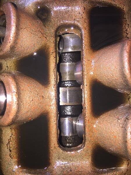

Number 1 is on the right.

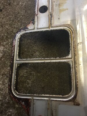

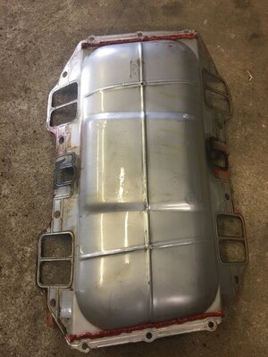

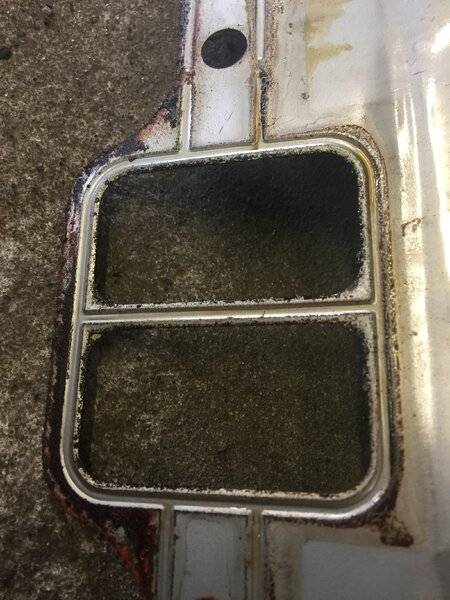

Another question. Does this style valley not use separate gaskets?

I needed to turn the pic to really see it.
The cam does look to be advanced, but there doesn’t appear to be enough differential to have the cam off 2.5 teeth.
Even on a mild hyd cam, when the timing set is off 2.5 teeth, the lifters will be off like 1/8th inch from each other.
From the factory, there are no gaskets on the valley pan.
That is the gasket.

So the cam doesn’t look advanced enough to be a tooth off? Should I look any further into the timing? I’m just trying to wrap my head around why it did what it did. I’m already almost at the tipping point on the engine itself and hate for it to grenade more parts.
Since we don’t really know what the cam is, we don’t know how much difference at TDC would be “normal”.
A run of the mill HFT cam that was installed 4* advanced would have the intake lifter at .020-.030” more lift than the exhaust at TDC.
A tooth is about 14*...... which would increase the differential by another .080-.090.
Your lifters don’t look like there’s that much difference.
