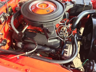

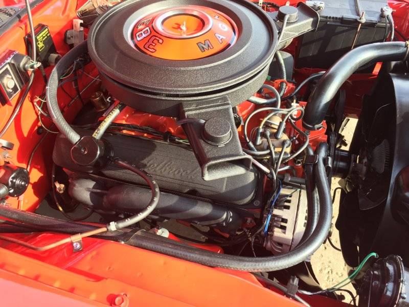

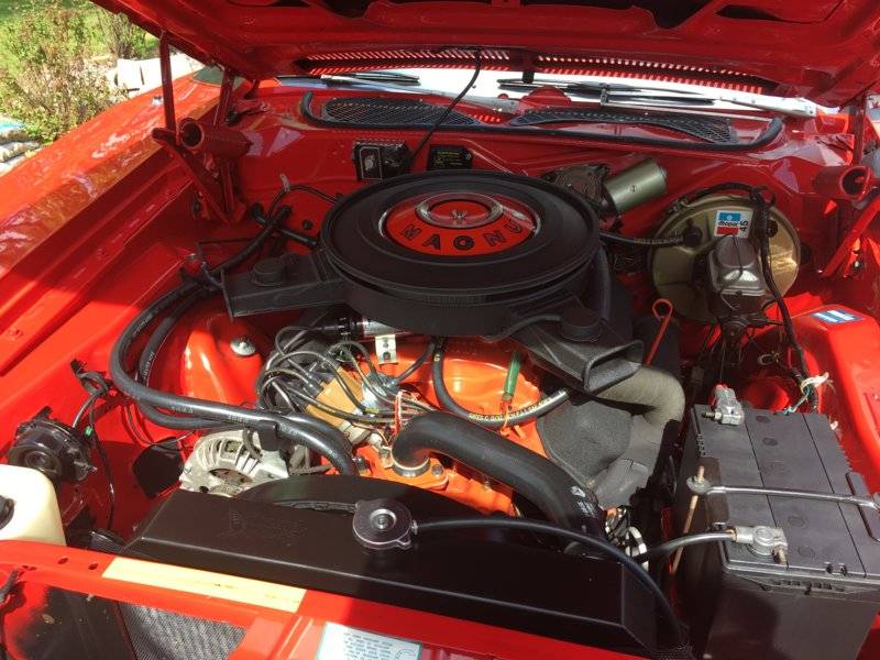

Running the Weiand Action Plus 8008 on my 383/432 Stroker with Edelbrock E Street Heads 75 cc and Comp Cams XE 275 HL Cam
I love the torque of the engine off idle as I can roast the tires all day long , even getting on the gas at 15-25 mph - Auto Trans - 3:91 Sure Grip
Would there bee any advantage on the street switching over to the Edelbrock RPM Intake ? It’s not tested here , and I don’t want to make the switch over say 5-10 HP on the street based on the height of the intake etc , coil location , factory kick down and running the factory dual snorkel air
But if it’s 20-30 HP ? Difference well
Shift around 5500-5600 Rpms
