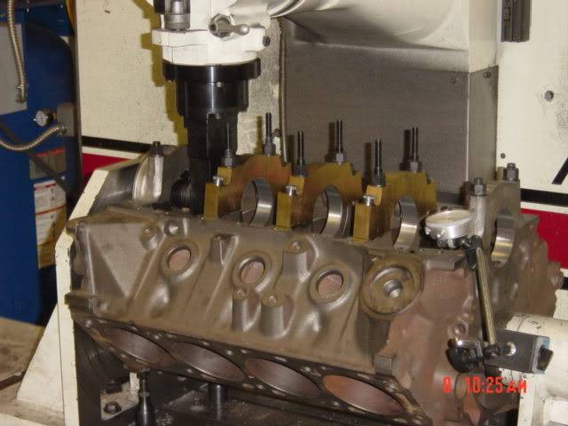

Speaking of line boring the B engines...don't you hate what Program Engineering did to the billet cap they make now? When you buy them for the RB engine, they sell you a cap that works for both B & RB engines so you have to bore the ever living hell out of them...they just cut the bearing tang deeper so they cover all the engines with one part number. Man, it takes forever...
I have never bored a 383/400 to the bigger bore. I usually build these combos for high rpm use and I like the slower bearing speeds with the small bore. I have always wondered if the crank is more rigid with the larger bearing though...the bearing selection is a bonus, I'll give you that.
When you get into the 4.250/4.375 stroke stuff, the cranks are more rigid. I think between that and the better bearing selection, I'm willing to accept the trade off in bearing speed. I know what you mean on the program caps, that was a pain although I was using a rottler F-67A so it was a little easier...Made the thrust a real easy procedure.
That Rottler machine is a Caddie, for sure. If I did any more volume, it would become a necessity. I am still boring with a Storm Vulcan line boring machine and I can only cut .020 at a pass, so it's a long job.
When you bore them on the F-67A, do you finish size them with a line hone?

Interesting comment about the Pro Gram caps. They told me it was to allow for variances in the bore but what you said makes sense. I'm fitting a set up for a hemi then will take it in to get it align bored.
Before I started using mostly the Mopar performance and aluminum Indy blocks, I used to install a lot of the cross bolt conversion caps on BB Mopars. Man, those were a lot of work to machine...I wonder if they leave a ton of meat to bore in them now too.
On the hemi block, how much machining is required to get the side registers? I have never installed a set on one.
The rottler is very rigid. I could cut the pro-gram caps taking out .050 in a pass easily. I usually made a pass like that to get in the ball park and then went to finer cuts. I rarely ever followed up with a line hone. I could finish on size with that machine and found it was a better bore than I could get with a line hone.
