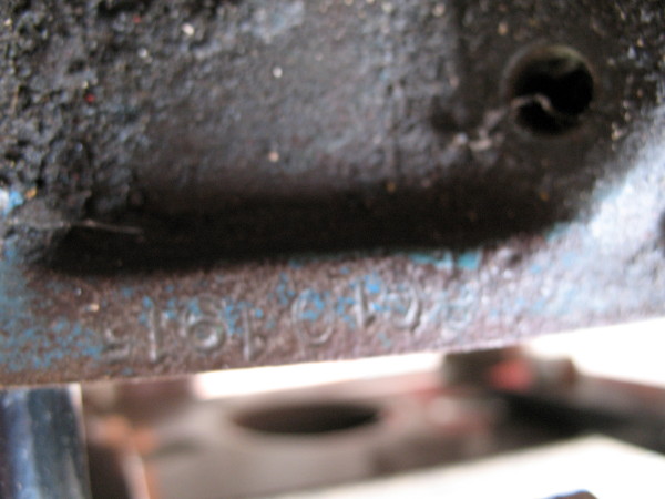

Look just behind the oil pressure sending unit, pre `69 blocks were stamped there right at the joint of the engine and trans. Tuff to see because the stamp was not done on a machined surface, rather the rough casting. I have a pic of the one on my `68 block on my laptop, I'll post it later. I think the transmission should be stamped in such a way that when it's bolted to the block the numbers are adjacent to eachother.

I don't know what the LL in the casting stands for, couldn't find any info on that in all my books, but here is a pic of the vin stamp on a `68 383.
you're right,it is very hard to see, might have to get a magnafying glass out. but i cleaned the area by the sending unit with a wire brush and still could not find even a hint of anything stamped there.
