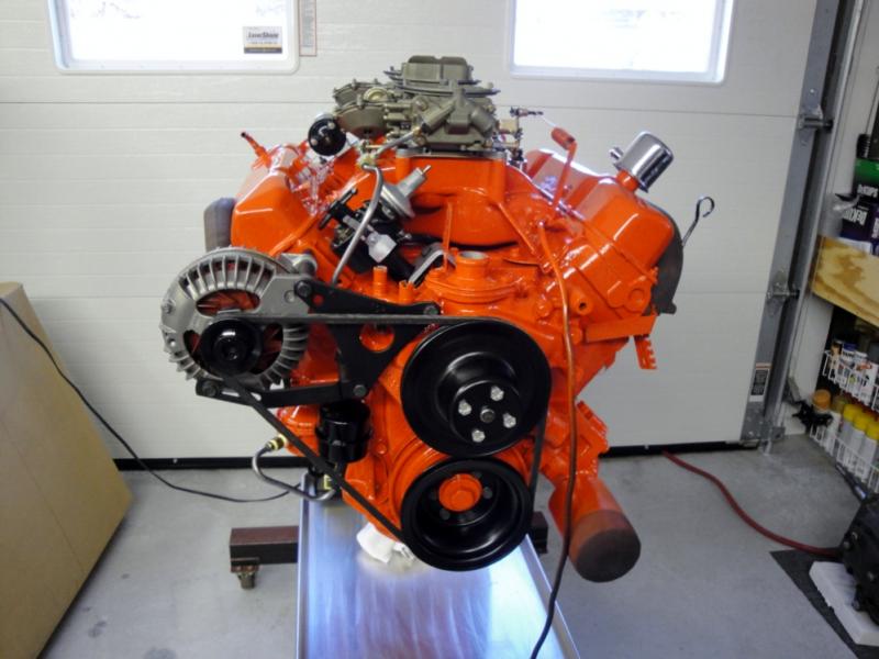

So, I want to run inside pulley to alternator and outside to p/steering. Will this make alt and p/s run in the correct direction?
short stack
they will always run in the "correct" direction. Looks as if the crank pulley us an under-driven style. Looks like the groves are the same size on each pulley, but the spacing for the groves is farther apart than stock, which means you are gonna have to do some spacing of the PS pump and maybe the alternator for belts to run true on each groove.
Also, note that the crank pulley is smaller than stock, which means the alternator & water pump are going to spin slower than normal as well. Which means lower alt output at idle and slower water movement in engine at idle as well.
Seems an awful lotta work to me....I would get with customer and see if this is really what he wants.
One more thing, you will need to run belts of the same "width" to avoid belt squeal also

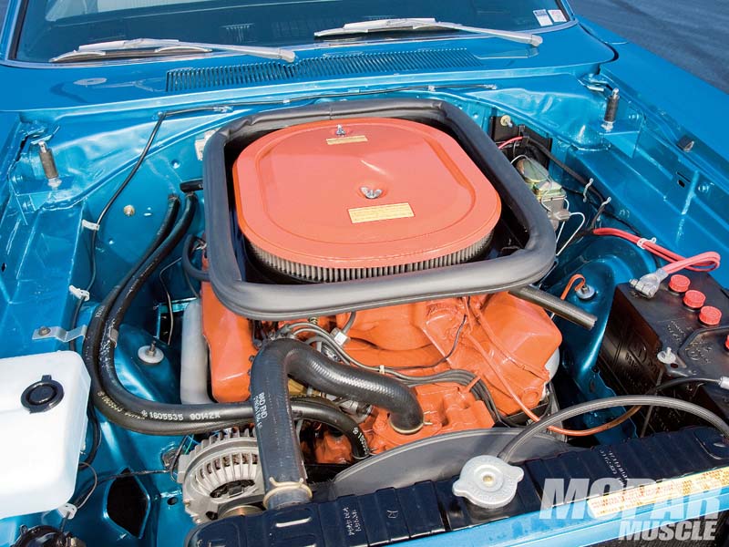

Here's an awesome picture of somebody's motor (I think a member here?). Great shot of the vapor separator. I've referenced this picture frequently during my build.

Here's a picture of a Six Pack 440 Bee with the heater hose layout. 1969 Service Manual confirms this layout for 383 and 440 engines. Note how the hoses crossover each other.
Front waterpump port goes to driver side outlet port on firewall. Rear waterpump port goes to passenger side inlet port.
