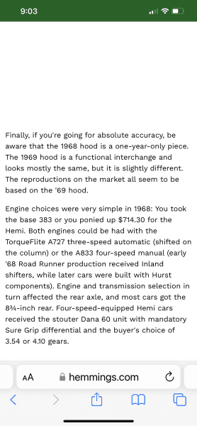

I just finished reading an article by Hemming’s called “1968 Road Runner Buyer’s Guide”, in which the mentioned for a 4.10 Sure Grip. I was aware of such an option and hadn’t seen it mentioned anywhere else. I’d like to see more proof of this option and “if” it is an option, what would the fender tag code be?

With 383, in 1968, with 8 3/4, 3.23 was standard, with 3.55 as option. The 3.91 came along for 1969.
A lot of magazine writers weren't born when these cars were produced. Unfortunately a lot of wrong information is in print. It will be confusing for future generations to restore these cars correctly. Youtube is even worse.

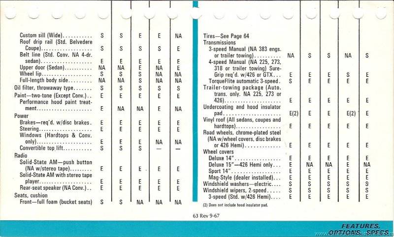

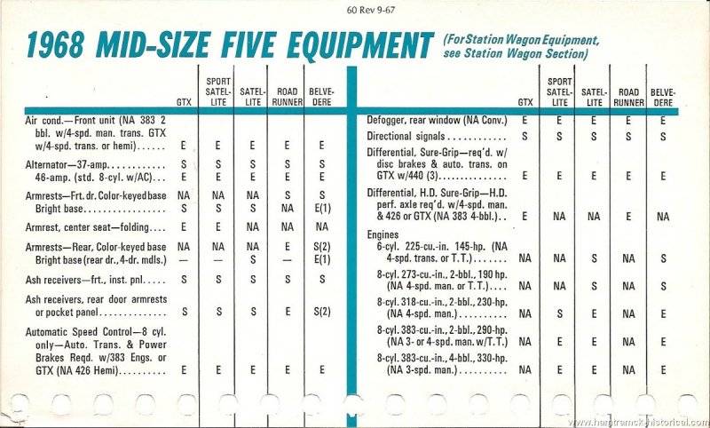

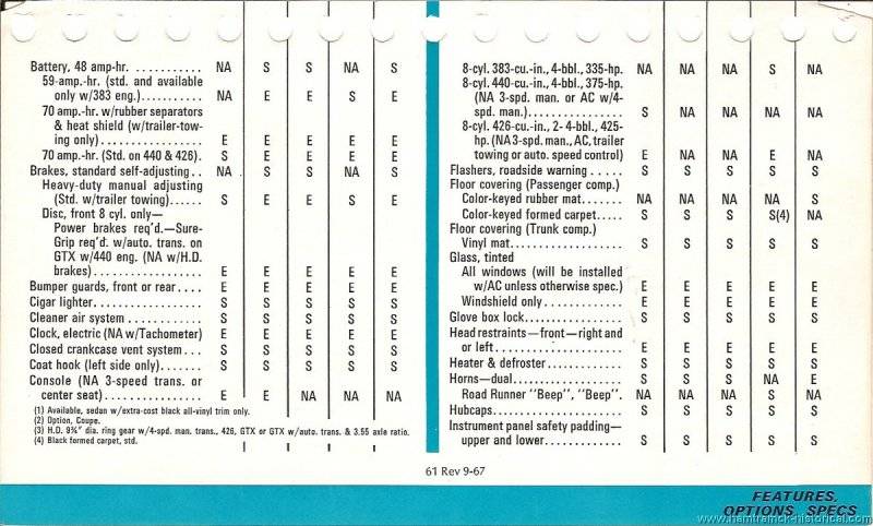

photos from Hamtramck site...
1968
**pages #2 & then page **#8-14 (*** page #12 specifically notes it too)
**page #2

**#9 sure-grip HD Axle package mentioned

**#11
68 Roadrunner Coupe Advert. #11 Belvedere GTX Satellite options accessaries.jpg
*** this is page #12

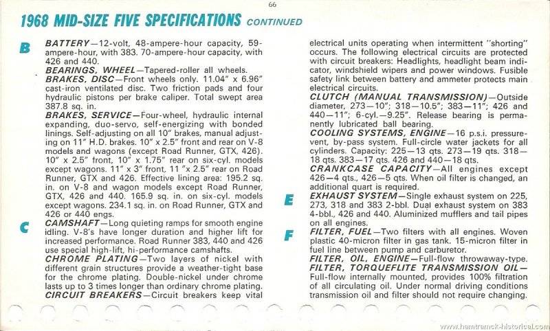

#14 4) different 383s offered in 'the mid-size 5'
