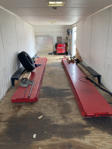

I went with wildfire for my 4 post and rotary for my 2 post. I had picked up my rotary from the dealer and 4 post delivered to my work and i delivered them myself on my car trailer. Yes many company’s will deliver and install. First figure what brand you want then ask the question I installed with wife and kids.

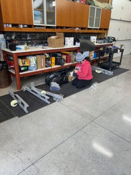

I have both an Advantage and a Wildfire 4 post lift. Picked both of them up at the nearest freight depot with a U-Haul rental car trailer. I assembled both by myself with the use of my engine hoist, rigging and blocking.

When I wanted to reassemble my BP unit, I was quoted almost $2k to put it together. I paid $500 the first time when I bought it. I'm not about to pay for someone's beach vacation as the companies were both in the valley on that 2k. I ended up doing it myself. A friend helped me get the pieces out of the trailer. We set the ramps on moving dollies. From there, it was me with a floor jack and grunt power.
I went and picked mine up with my car trailer, forklift loaded. Unloaded and assembled by myself using my engine hoist. Easy peasy.

I chose an Advantage 11,000 lbs lift over Wildfire just because of a package deal they offered and they had a warehouse about 2 hours away. They loaded on my car trailer and a few hours later it was together.

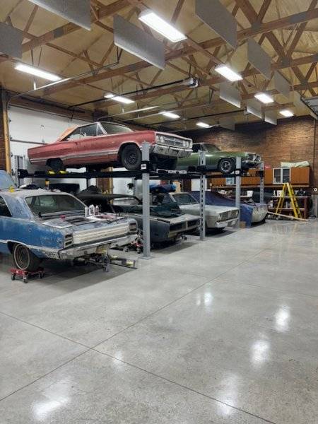

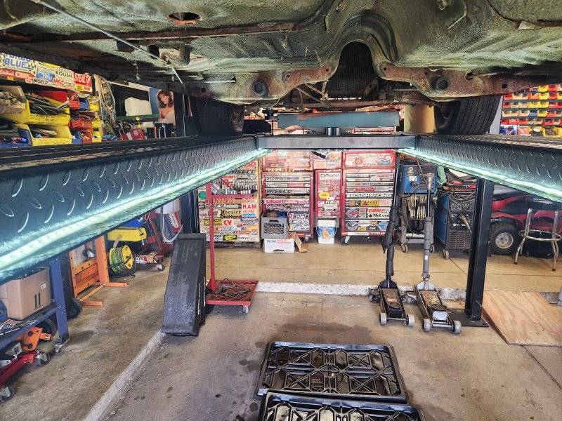

I installed magnetic LED light strips on to my lift also. Don't ever need a drop light. I also fabbed up some brackets to mount a winch for when I have to winch up non-running vehicles up the driveway incline and up onto the hoist.
Like that winch idea. One thing, is your lift bolted down or do you have to tie it to the building to use the winch. Mine isn't bolted down so I would have to tie the lift to the building. Maybe I just need to mount the winch to the building.
Mine is anchored down.
OK, I have wheels for mine so I can move it around. Will look under my work bench to see about winch location. Thanks
