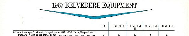

You could get a 383 4 speed with A/C, but not a 440 4 speed. So the GTX, if factory A/C equipped, will be an automatic

I've seen some documentation that a 440 4-speed GTX with A/C was not available from 1968 on, but I believe it was available in the '67 (according to the Red Book). What do you base your statement on?

Dan, while it can be a handy reference for some things, there are a lot of mistakes in the Red Book. Here is the information from the '67 Plymouth Data book:
