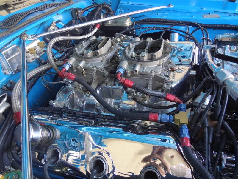

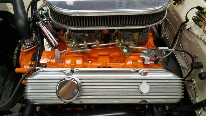

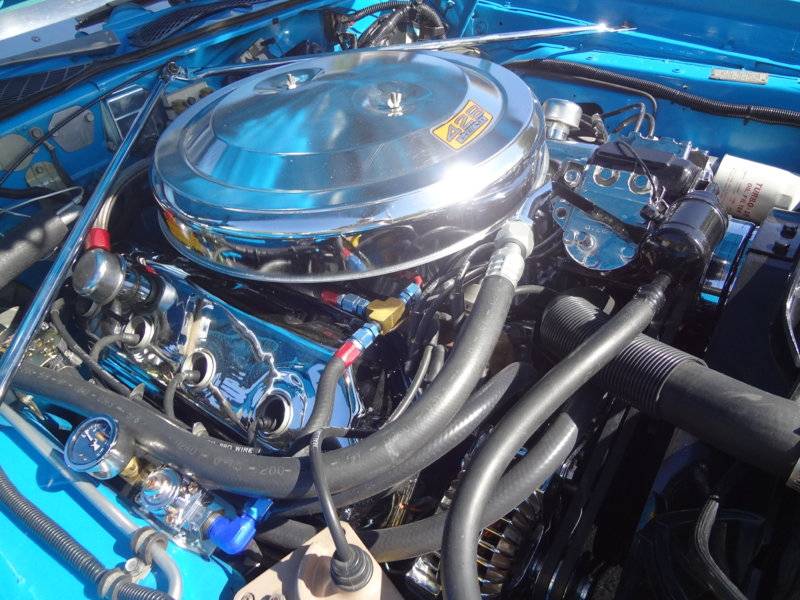

I modified my Carbs Edelbrock 1406 and made my own linkage back in the early 80's. I welded a second throttle lever to my main carb, tapped both carburetor inlets on the passengers side and modified my chrome dome base. Here's some pix.
I went with the 1405 and a manual choke on the rear. Removed the choke plate on the front carb. The 1405 has a heaver needle and seat on the floats and the jetting and springs are a bit richer. I believe the 1406 was built more for pollution. Others can comment on this.
After some trial and error, I went with these parts and I'm very pleased.
This part is a must for Mopar to Eldebrock carbs.
This piece works great for progressive or one to one setup.

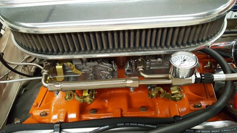

This piece was easy to install, it's adjustable between carbs and hasn't ever leaked. I used AN fittings and a braided hose down to the fuel pump.
Maybe Eldebrock sells all of these parts as a kit?

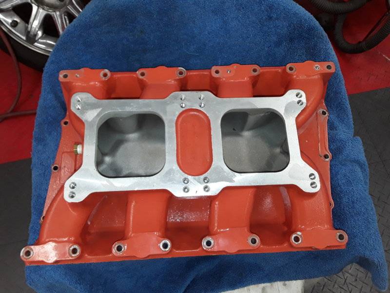

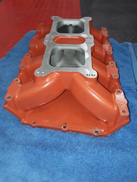

I have a very nice Edelbrock single plane air gap Intake with the coil bracket for sale $450 plus shipping if you are interested.
khryslerkid; Nice job! Well thought out and very functional. One of the cleanest set-ups I've seen...

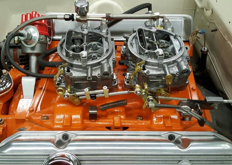

Runs pretty good so far, just changed to lighter metering rod springs, set idle speed and adjusted idle mixture. Will dial it in on the dyno in the spring.
The AVS2 steps up a bit at the air cleaner stud so I'll need to either raise or remove the bridges on the air cleaner base.
Also, the ports on this intake are raised a bit in comparison to the stock hemi heads. I used Cometic C5598-047 (.047 thick) gaskets instead of the stock thickness .060 which dropped it down a bit. Port floors then lined up perfect. Top of intake port was about .025 above the port on the head which I thought was OK for now.
I plan to pull it apart at some point to do a roller cam and head porting and I'll match it then.

That didn't take you long! Sounds great, looks great. Your linkage and fuel supply looks nice. Great looking car also:thumbsup:
