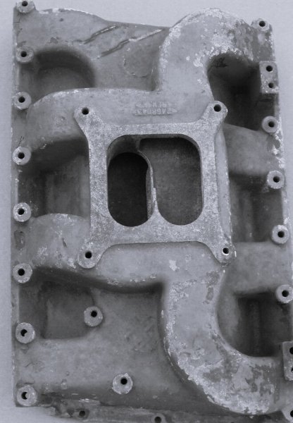

Hello I have a 426 Nascar Magnesium intake. I am building up a race hemi what size and manufacture carb was used in the single nascar applications? Also what air cleaner was used ? Thanks

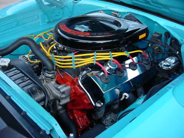

4 barrel Holley. In your application you can use a 850-1000 cfm. Whatever you like. The air cleaner varied a little. Hooked to the cowl for fresh air.

I assume he's talking about the dual plane. They are great.

There are mag bathtubs and there are mag single 4-bbl dual planes. I assume that's what he has. I wanted to put a mag bathtub on my Superbird but a well informed gentleman told me if I did I would be taking it off soon.
Usually after an hour I can get one off of Amazon Photos. It's only been 30 minutes.
Here's what the air cleaner looks like. I wouldn't recommend looking for one. That's a mag dual plane under there but it looks like all other dual planes.
The also made the dual plane in aluminum and they made Holley Dominator tops for the bathtub.
I would love to see the inside of the bathtub. It doesn't look to me like it would work well anywhere!

Why would you suggest I do not look for the air cleaner?

Your manifold is a normal dual plane. They are great for any kind of driving.
