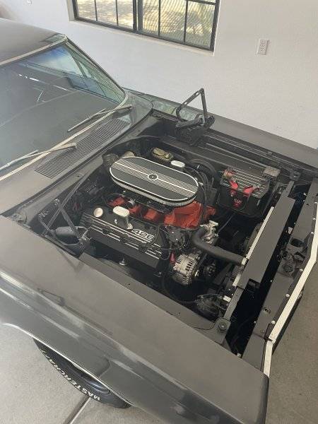

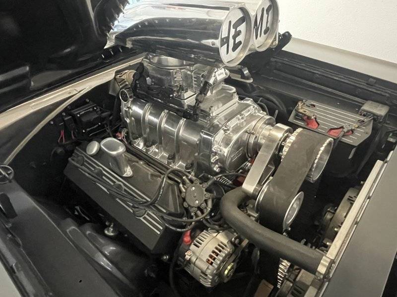

I just pulled the 6-71 blower off my Hemi and want to keep everything under the stock hood. I would like to be around 600hp. Is that possible with an original 68 block or do I need an aftermarket block? My engine has about 100 miles on it since being built in the late 80’s. It is .030 over with Arias blower pistons. I am assuming stock crank, rods. It does have Stage V aluminum heads. If I can get 600hp with this block and just need to swap out the internals, what would you all recommend for pistons, crank, rods, cam? This is in a 68 GTX with 4 speed, Dana 60 3.23 gears and will be street driven only. Or should I sell this motor to someone you could use a date correct motor and get a crate hemi? It already has an original 68 hemi k member, so I don’t want to go through the hassle of replacing it as well. I don’t have any engine builders around here that I would be confident enough that they knew what they were talking about. My next thought was to call Ray Barton. Thanks IMG_0712.jpegIMG_9993.jpeg
