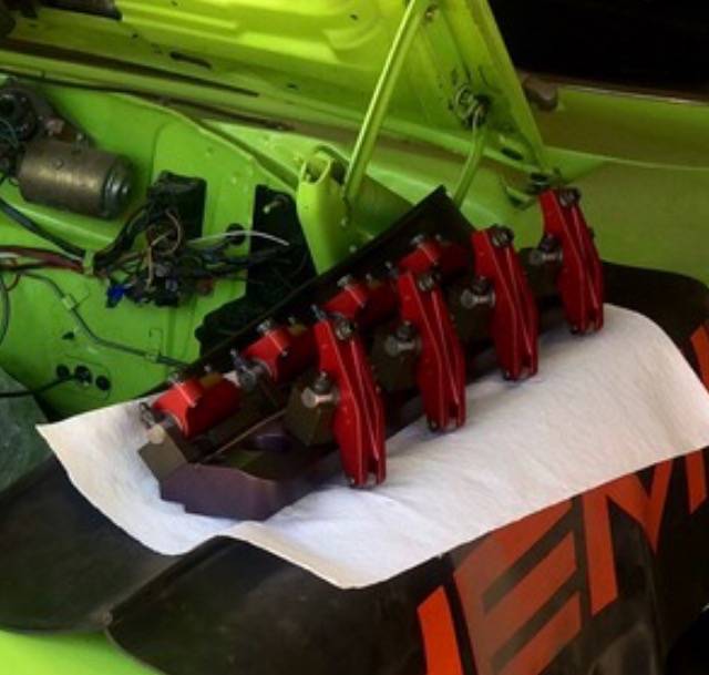

I learned from Ray barton guys a few tricks, one for street guys is use only solid rollers no Hydraulic roller cams. Also i am using Ed iskaderian Bronze bushed roller instead of needles and Stage 5 rockers. excessive for a street motor but these heads alwys have been a bit quirky for me. What d9ameter push rods are you running?? Are you using springs for side loading or lock rings?
Well, a good thing you bring up the valve train. I haven´t decided what to use yet.
Car is a 68 Barracuda w. a stick (SS/B) and 4.88 gears. Tires are 10.5X15" and 30" tall at the most.
Camshaft is Roller Crane R290 (.700 lift). I mention this for you to estimate rpm:s...
Also this racer will only see some 25, at the most, Nostalgia and Exhibition Races a year.
Would using the stock valve train be risky?
Half or so of the rockers are wide pad.
The lowest cup height lifters usually work the best. I usually run comp 829-16 but I had a new set of 892's so I used those this time. I'm running 3/8" heavy wall pushrods because my set of 7/16 were hitting the heads even with the 829 lifters. As for rockers, I run the RBRE.
