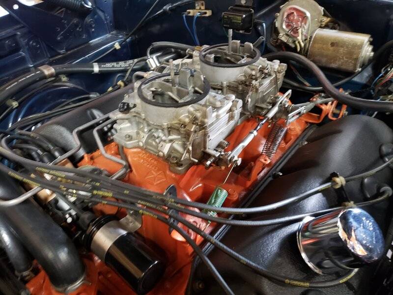

I don't seem to have the idle stop solenoid people are talking about. What I do have is a green canister on the vacuum line. Could this be a source of my problems? I'd upload a pic but the website is giving me an error. I believe this green cannister is a California only emission device.

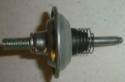

Do you have one of the on the pass side of the rear carb (a dash pot - I used the wrong term above).
They may only be on 4-speed cars. They will cause a hanging high idle speed that gradually decreases. My friend with a 69 Hemi tells me they are not driver friendly.
The dashpot is '69 Hemi 4spd only. I don't have any trouble with mine, because it has been missing for 40 years.
Do you have one of the on the pass side of the rear carb (a dash pot - I used the wrong term above).View attachment 1110999 They may only be on 4-speed cars. They will cause a hanging high idle speed that gradually decreases. My friend with a 69 Hemi tells me they are not driver friendly.

OK - that’s good. I remember having seen that green canister do-hickey thing but I don’t remember it’s function. Maybe something to do with the choke. Mrhemi probably knows.
