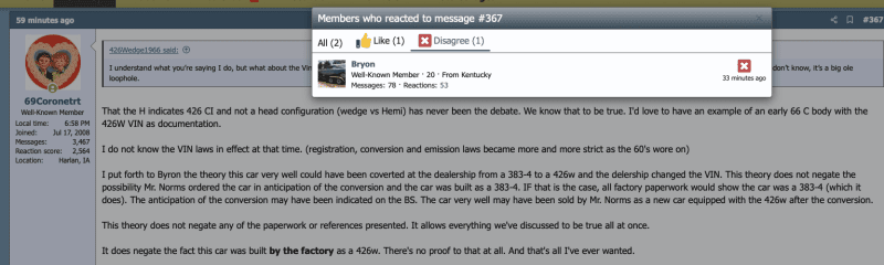

I understand what you’re saying I do, but what about the Vin tag? I’ve talked to a few well known Mopar lovers including Herb McCandless who said the H was for 426 cubic inches not just for Hemi. I don’t know, it’s a big ole loophole.
That the H indicates 426 CI and not a head configuration (wedge vs Hemi) has never been the debate. We know that to be true. I'd love to have an example of an early 66 C body with the 426W VIN as documentation.
I do not know the VIN laws in effect at that time. (registration, conversion and emission laws became more and more strict as the 60's wore on)
I put forth to Byron the theory this car very well could have been coverted at the dealership from a 383-4 to a 426w and the delership changed the VIN. This theory does not negate the possibility Mr. Norms ordered the car in anticipation of the conversion and the car was built as a 383-4. IF that is the case, all factory paperwork would show the car was a 383-4 (which it does). The anticipation of the conversion may have been indicated on the BS. The car very well may have been sold by Mr. Norms as a new car equipped with the 426w after the conversion.
This theory does not negate any of the paperwork or references presented. It allows everything we've discussed to be true all at once.
It does negate the fact this car was built by the factory as a 426w. There's no proof to that at all. And that's all I've ever wanted.
