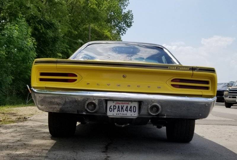

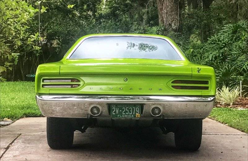

Nice looking car.
70 Plymouths have the best looking front ends
Nice looking car.
Yeah, and dat *** ain't bad either!
