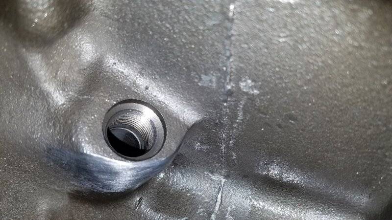

I want to start by thanking everyone on this forum, i have been learning so much and have been steering my plan accordingly when it comes to what stroker to throw in my belvedere so thank you! Im inexperienced to say the least and this is giving me a lot of confidence for my build. Currently I'm thinking a 0.030" over bore 440 with 4.375" stroke because apparently thats the longest i can go without switching to external oiling system (pls feel free to confirm or deny that). What kind of clearancing would such a stroke require? I cant remember where but i saw one build where it was hitting the block where the pickup threaded in, would that be something i should be concerned about? And how to i mitigate that issue as well as any other clearance related issues i may encounter? Assuming i heard right about being able to maintain an internal oiling system with a 4.375" stroke, i was thinking this combo of parts, milodon 7" oil pan and 440 source stroker pickup and windage tray, think that'd work? (Also this is for a street build so no 7,000rpm shifts screaming down the quarter if that means anything)

I have not built a stroker. From what I understand, for your stroke, you just need to grind off some metal on the edge of the oil pickup hole in the engine block...just a little, & the pickup will still seal. (from what I understand)
Thats good, ive seen people put theadlocker in there and im sure that'll help seal it a bit
I had to grind that area by the oil pickup tube and all eight lower cylinders in a U shape to clear the rod bolts during rotation on my 500" 440 block. The thread locker will definitely help seal and it'll keep your pickup from rotating on you at all during operation.
That grinding shouldn't affect longevity right? I want this car to last a long time with just some regular maintenance not looking for another rebuild in a couple years
Not at all......mine was so low on the cylinder wall that the piston skirt didn't even go that low or come close to the area. It was just so when the rod swings by the lower wall that it doesn't clip the block with the cap nut and lets it clear well. The only sucky thing about it all is assembling the one set of rods to give you an idea of how much needs to come out before grinding then taking it apart and keeping everything really REALLY clean for reassembly later. Also when you do that make sure you get that metal dust from grinding out of everywhere inside the block. When it seems like its all out and clean, clean it one more time just to be sure.
I also think with your stroke you may have to notch the area on the oil pan rail where the rod comes around as well to clear the rod nut/stud(8 notches total just like the cylinder wall). Mine was fine, but really close and I remember a note saying that it is a possibility of needing to do that.
Since you said it's a street build with no screaming passes down the track, personally I would opt for the 4.25" stroke with the 2.2" journal size. The extra few cubes you'll get with the longer crankshaft isn't worth it IMO, when you can make tons of power on the street with the 4.25" which is 505 cubes with just a .030" overbore, or 512 @ +.060. They typically go in with no trouble.

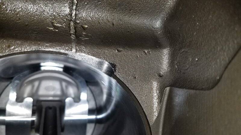

Now, my machinist did kiss a few spots with the grinder on my 505", but even then he said things weren't contacting, just that he likes more wiggle room than less when possible.
^^^ Agree 200% with Beanhead. My 505" motor burns tires off at 35-45 mph! Those are the exact spots mine had to be ground as well.
