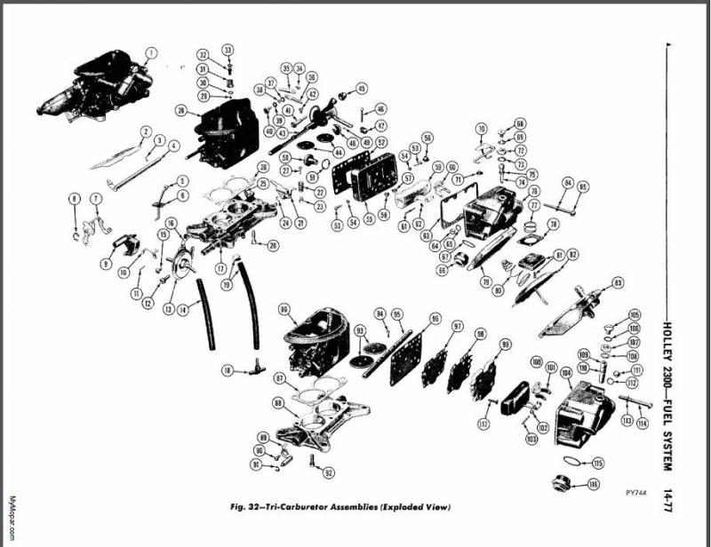

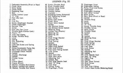

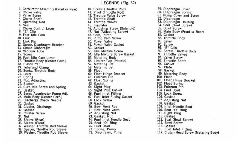

2300 center exploded.jpg2300 center legend.jpgPerhaps you could point to the article in question. If it's the nipple near where #17 is pointing, that's for crankcase ventilation (PCV)

Heres a pic I pilfered and I circled what it is Im asking about
