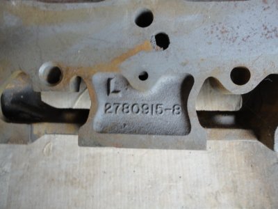

440 67 915 heads on a 67 383, stock from factory?

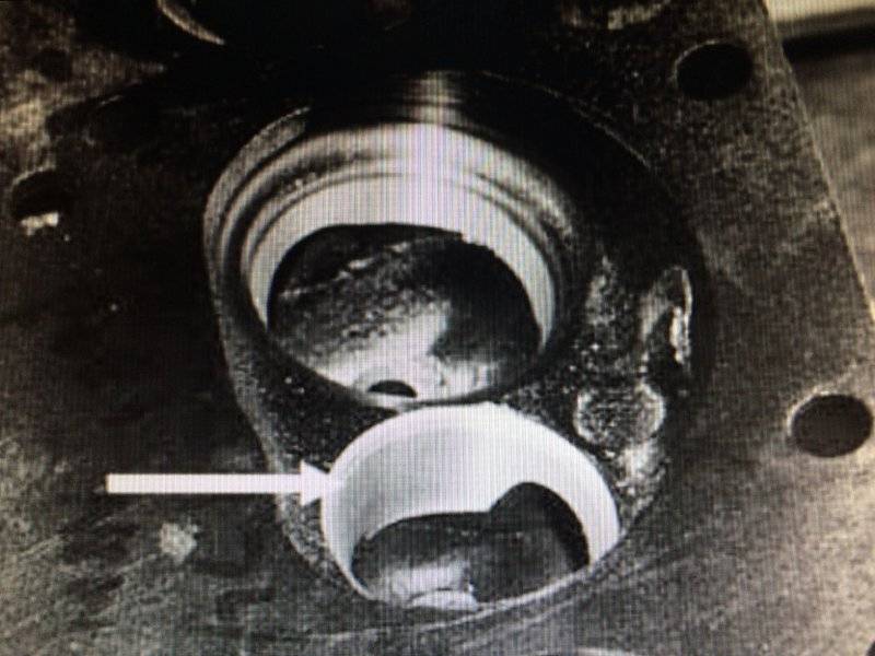

If you go to a 1.74 exhaust valve you have to open the throats up otherwise its useless!
Most 915 heads with 1.60 exhaust are cast with a "K" and 1.74 are cast with an "L". You just might have the 1.74 exhaust in them
