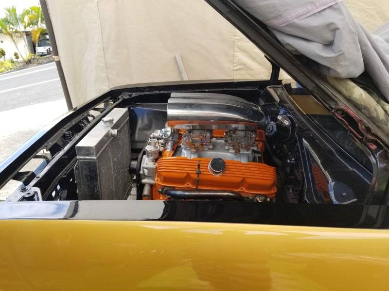

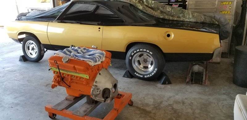

440/6pac carb kits ?
So, FYI . Not To Get Anyone Mad ! But I am planning on using it with a 4speed !
The 6pac was off an auto ! Any changes that I need to make ?
1975 440 cast crank stock bottom with 488 purple cam, 67 915CC heads.
10.5 Bellhousing with stock clutch for now. until I get any bugs worked out !
833/4speed to a 3.91 Sure grip shortened 8.75 rear !
Much Mahalo & Shaka Bradda ! C

Only difference is jet size,4391 4 spd uses #64,4392 auto uses # 63,end metering plates are the same.With that cam I doubt you would need to go anymore than the #64,possibly #65 but I doubt it.
