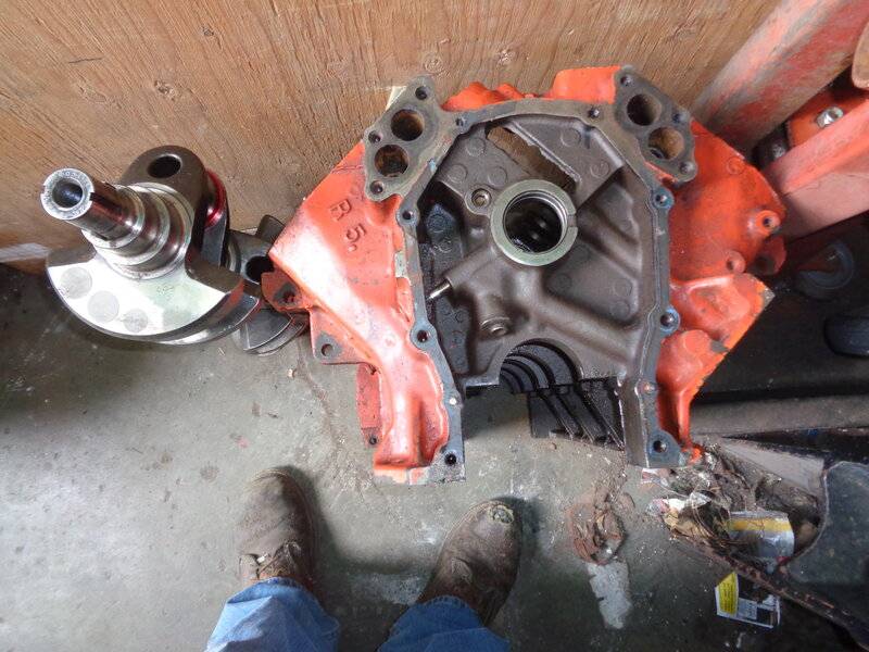

    I can vouch for that. When we were machining my Hemi block. It took days boring the cam tunnel out for 55MM roller cam bearings. Everyone commented on the quality of iron content. Even better than all of the aftermarket Dart Racing blocks we machine.

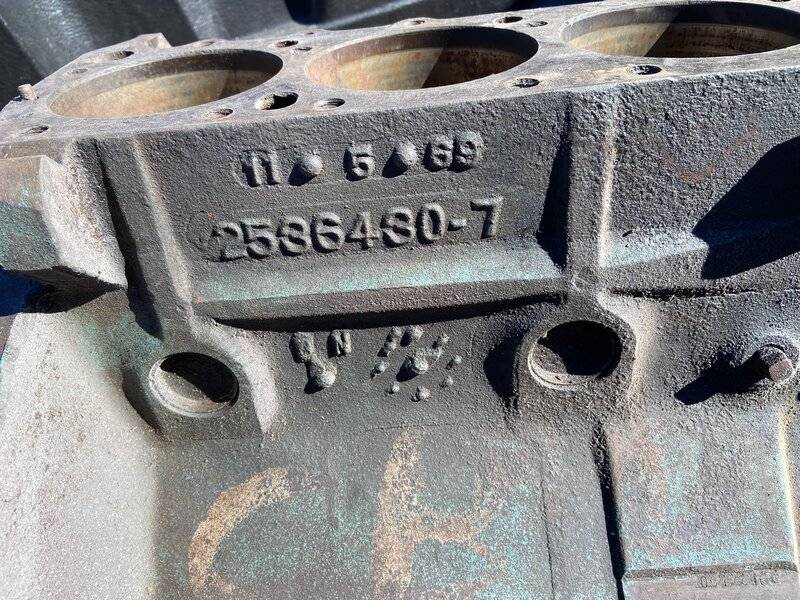

      Update. The stars aligned and I am now the proud owner of a ‘69 standard bore short block. The seller couldn’t have been any better, and his price was fair, not crazy.
      Now the fun begins.

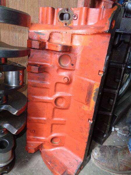

        thje motorhome 440 block you want is like this one if your going later 440's , these have extra thick cylinder walls they can be bored to 4.5 if needed . most can't go bigger than 4.38 the walls are much thinner . even the hp blocks . DSC00728.JPG DSC00729.JPG

            doug , the machinist did a sonic test all the cylinders , the block is .06 over now and he claimed we could go that big on this one , of course i'd want to stay on the smaller sized bore . racetec had no issues on pistons , and these lots of ring sizes in between 4.38 and 4.5 bores . my plan is the min bore on that block and 4.5 bryant crank 7.1 rods , alum stage 6 mw ported . mw intake to make 800 hp at 6500 rpm with monster torque .

            It would be nice to see that block with a middle frost plug out of it, it would have to be siamesed to go 4.500. I am not saying your machinist is wrong, just that it would be an odd block.

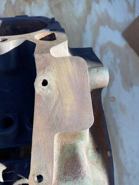

                    I dropped the block off at the machine shop to have it hot-tanked and magna fluxed. He’s really backed up but I’m in no rush.
                    It measures up to be a standard bore with a steel crank. Fingers crossed!

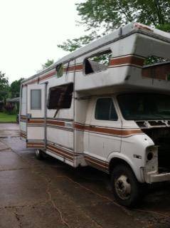

                      I have been trying to PM but no luck you would you try a PM to me? I'd like to talk to you about the motorhome engine you have. Many thanks
