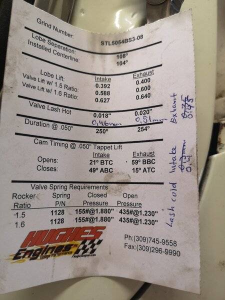

Well, a couple of years has went by, so here's an update.
Managed to do 12.24 sec with the xe284h hydraulic cam with open exhaust.
Changed to a hughes 250/254 dur 0.588/0.6 lift solid flat tappet cam (changed springs as well) and went 12.0 flat./110mph.
The car still feels down on power after 5000ish rpm. (thought the cam/lifter swap would cure the problem).
Have a msd billet distributor I will install during this winter, hopefully this will help since I'm running a old chrysler dizzy.
My thoughts lately has been on the torque converter, can a bad/miss matched torque converter give the symptoms/feeling of loss of power?
What's your thoughts on this?

Some thoughts...
* what rpm are you shifting at ?
* Still the Performer rpm Intake ? (they have a very poor Port Match if not corrected depending upon Frt/Rear positioning up to ~15% of 2 ports can be blocked)
* What T/Converter are you using ?
Just say'in... I'd like to get more info on yours to identify differences.... as we have a few guys running similar build 440's running high 11's with just the XE284 ?

Shifting at about 5500rpm (tried different rpms)
Still using the rpm intake.
All the runs was made with the Hughes 3000 tq

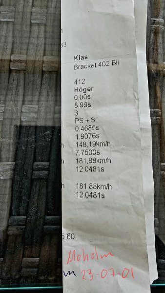

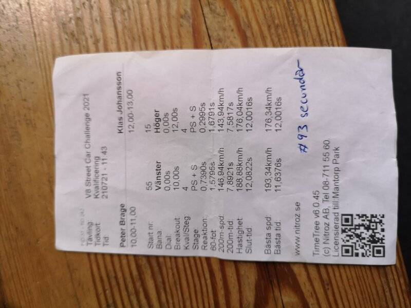

Update.
Had the opportunity to test the new torque converter last weekend.
110mph with old hughes 11" 3000rpm tq
114mph with new custom made 9.5"
Really bad track, my best 60 foot was 1.9076 sec.
I've been 1.68 on a prepped track.
On a good track I believe the car can go 11.6- 11.7s
