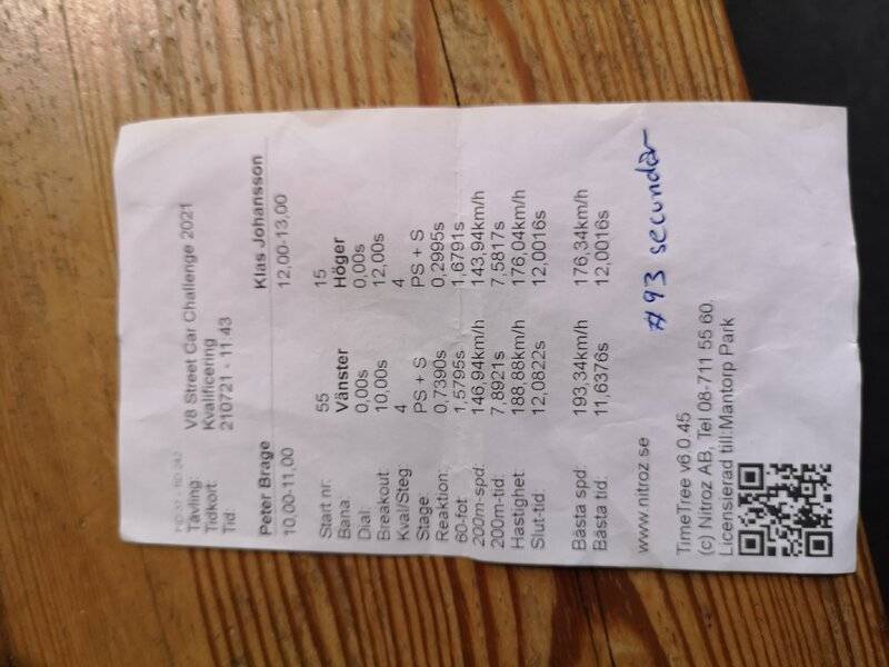

Well, a couple of years has went by, so here's an update.
Managed to do 12.24 sec with the xe284h hydraulic cam with open exhaust.
Changed to a hughes 250/254 dur 0.588/0.6 lift solid flat tappet cam (changed springs as well) and went 12.0 flat./110mph.

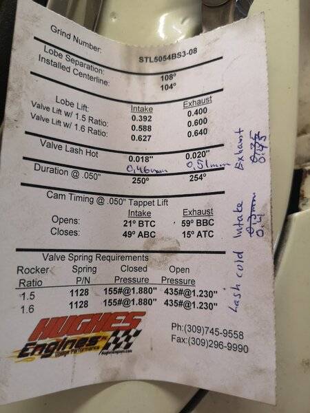

You said you went to a solid cam,, what rockers did you use?
First thing I would do would be take stock of your valve springs. Get a height mike to see where the springs are, and how much of the right load you have on them. Fix if need be. Then call Hughes and see how much you can tighten the lash to see if the motor likes it or not. I would think you can go as tight as . 014 hot. Check where the cam is installed. If you are at recommended install, fine. You could also try 2 to 4 degrees advance, especially if you have less than ideal compression. Also do you have collecters on the car?

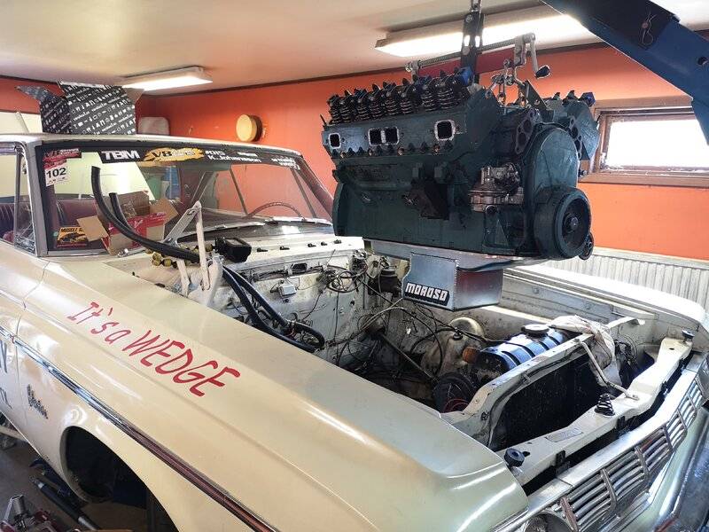

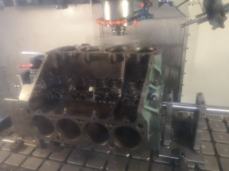

The Swedish winter is over, so time for an update!

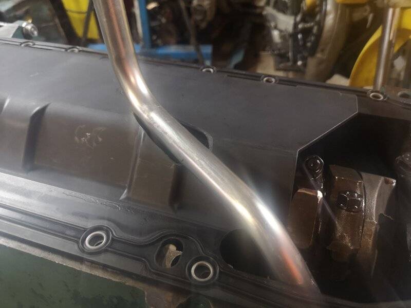

My plan for this winter was to change the oilpan, add a windage trayand install my msd dizzy.
Well.... When I dropped the old pan, I decided to check the bearings, they were bad so I janked the engine out to change bearings.

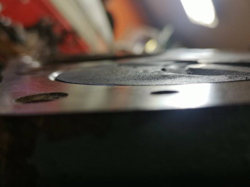

Long story short, my brother and I decided to build a fixture so we could topdeck our blocks.
Went from 10.1 to 10.7 compression ratio.
Since the engine was out, I also swaped my Hughes 3000stall 11" torque converter for a custom made 9.5" converter.
Hopefully will this combo send me in to the 11s at the quarter.

12.0 @ 110 MPH seems like the car is working pretty good.
My '71 Charger (4,150 lb street car) could only manage 12.5 @ 110 MPH with the old engine (at mile-high altitude.)
The new engine has ran 120 MPH in the quarter, but 60' are worse, and Et's in the 11.6-11.7 range.
Likely will take out the 0.960" Torsen bars and replace them with bars from a 318 car, and remove the KYB shocks and install some adjustible shocks and see if I can get the car to hook up?
