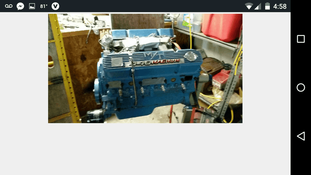

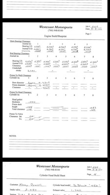

I have the opportunity to purchase a 440 that is already built with 0 miles. I would like some opinions on the build. Concerns if any. It has ported heads which I might leave but am not opposed to swapping for Eddie's which I know would crank up the compression ratio and hp. My biggest question is the Cam specs.
Thanks in advance!

If the specs are correct looks like a well built engine. The cam is a little big @ .050 for that compression. I've had good luck with the Mopar Performance Hemi grind cam in Engines like this. A custom ground cam would be best. The Isky Mega cam is a old design but so is the Mopar Performance stuff.

I agree with you on the cam. I was thinking about an Eddie 7194. Lift .480/.495 Duration @ .050: 238'/246'. As you can see this is a 17 year old build that has been in storage. Possibly change to Eddie Performer or Victor heads with smaller combustion chamber for higher comp ratio.

If the cylinder condition checks out I will probably get it because the guy is asking $1,000 for it. That seems like a really good price for what it is. That gives me a lot of $ for changing things out like heads and cam. The build sheet shows compression ratio @ 8.7-1. piston to deck shows .088 in the hole. What about a piston swap to increase comp? Goals is to have a streetable and run pump gas.

What do you all think about the cam? Is it too much for the street? It's an Isky 280 Mega
If the 452 heads were ported and are only flowing 132 cfm @ .500" @ 10" of depression, you have heads that are flowing 220 cfm corrected to 28" and that is a poor flowing head. Good idea to replace them.
