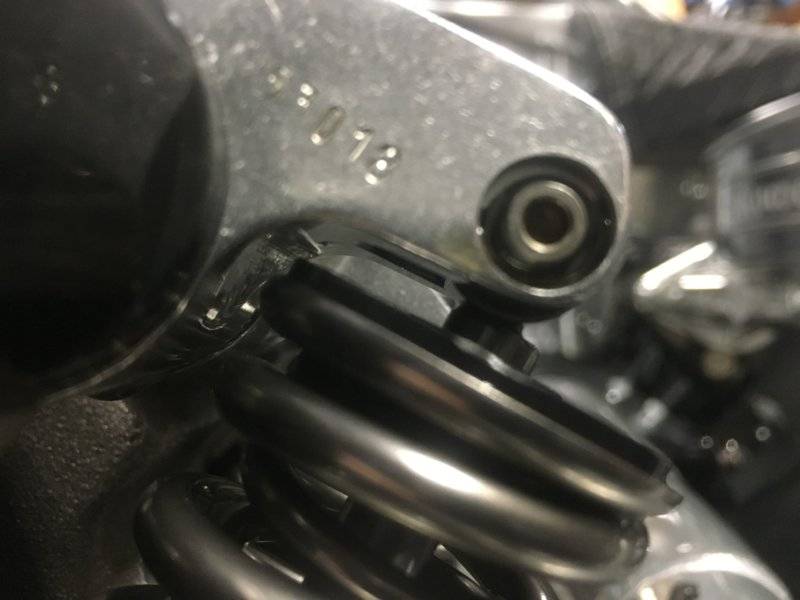

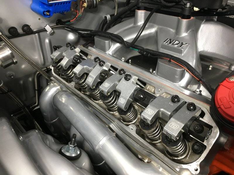

Has the rocker shaft suffered from lack of oil supply or not enough side clearance on the rocker arm?

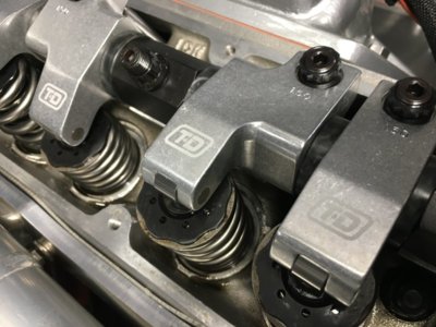

Correct me if im wrong, aren't Indy rockers T&D?? Or not any more?
The Indy (Dove) Rockers are junk! I switched out to T&D and no comparison. T&D rockers use roller bearings on the shaft, the Indy's do not!

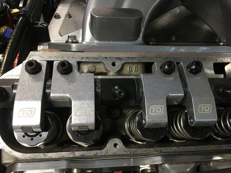

Plenty of threads showing on those adjusters. I like having 1 or 2
Two is my limit but strive for less.
I don't think they are T&D. Several reports of the Indy rockers breaking.
I think the intake pushrod is bent too?
Maybe the exhaust pushrod bent, and fell out of the adjuster, then beat the rocker to death.
Those Rockers look like Harlan Sharpe? They are pretty good, but I don't know the lift and spring pressure used here? I mean the rocker could have cracked? sounds like not too may cycles on them?
Also, what type of rocker side clearance?
Indy rockers have a long history of failure but don't know if it's caused by customers or not. And didn't know T&D had aluminum rockers....and I'm one that does not like aluminum rockers.
