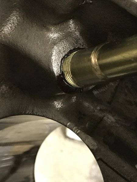

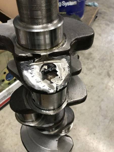

A cracked oil tube boss doesn't mean the block is junk, but it should be properly fixed, not 'glued' obviously..the grinding on the crank is ugly for sure, but doesn't mean it's not usable...

Were the engine parts your's, or the builder's?? Just looking at the hole location for the pickup tube, easy to see it was off at that end. Should have been more centered on that boss.
I had to open my port (440) to 1/2", though the original hole was located right.

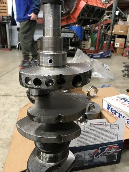

The right builder might be able to fix it, if it's worth it. I would have left that crank in the scrap heap.
The pickup hole can be fixed with a "Pipe Thread" Timesert. The drill will need to be rigid (preferably on a Bridgeport) and use an end mill to reposition the hole, then drill to size for the insert. The crank is junk now. It was hacked up by someone who does not know how to balance an engine, and/or does not know how to operate his equipment. The front throw was screwed because he was chasing a moving balance measurement. The rod pin area was welded to correct his moving balance issue. A properly set up machine will have you add/remove material from 2 planes which are established when you set up the job, and these are usually the front and rear throws. I have a 340 in here that was ruined the same way; an inexperienced balancer operator or hack. That guy welded the rear crank flange to correct his mistakes. In my opinion, from the parts boxes you have laying around in your picture, he seems to have mostly been a parts installer. Fix the block, replace the crank, rebalance everything correctly, correct the valvetrain issue, and you will be fine. For that kind of money, did the block get alignhoned and squared too?

I did this on my 426W just so I could say that I did. It was a real PITA to say the least doing it by hand. A Bridgeport would make short work of it. I agree that the 3/8" was fine as had been for many years. I don't think they had all of these new fangled 1/2" Hemi pickups when I did mine. I had to cut out 2" of tube, and reweld it back together. I was worried in the beginning it would leak, and create foam, but I never had an issue with it.

Shoddy work gluing in a piece of the crank.

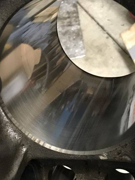

In 2013 I bought a 727 from a member here (or possibly former member now), and started discussing engines. He claimed to be a builder and could easily build me a 440. I entered into a deal with him shoveling him overtime money as I could afford it. Approx. 3 years later I had a finished engine and I traveled to Washington to help do the break in. I then stored the motor and installed it summer of 2018 and finally drove the car this last summer. I had maybe 200 miles on it when a rocker arm broke and bent two pushrods. I took it to the new builder who is a professional to diagnose. He tore into the engine and discovered a lot of sketchy work. The enlarged oiling boss from 3/8 to 1/2 cracked the block and was glued, the crank had material ground off and had been welded on! (pics).

The block at the pickup can be repaired, or you can convert to external oil pickup. I have seen pickup tubes welded to the block because the 1/2" pickup conversion was done wrong.
Not sure about the cylinder scratching can't really tell from the photo? Check ring gap and if the ends were de-burred?
If Tungsten was installed in the crank, I have seen the crank welded so it won't come out, but nothing like what your crank looks like.
Did the person balance the crank too, or have another shop do that work?
